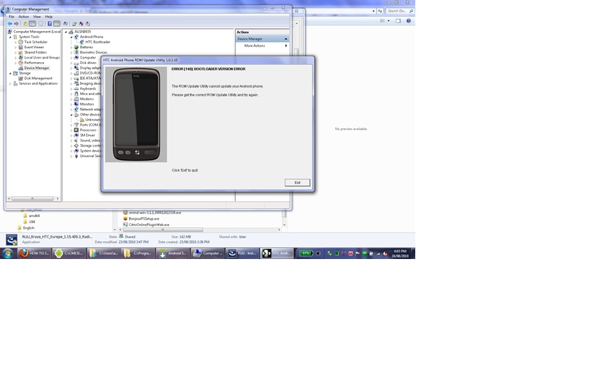

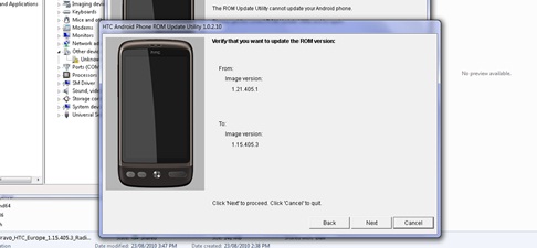

Hi,
I am having trouble running the ROM image.
RUU_Bravo_HTC_Europe_1.15.405.3_Radio_32.30.00.28U_4.05.00.11_release_121865
When I run the file, the phone reboots the bootloader and then i get messages saying the phone is being wiped and that the new image is being sent to the phone, but then it fails with the attached error msg.
"error [140]: bootloader version error"
Here are the specifics of my phone:
firmware ver. 2.1 update 1
baseband ver 32.36.00.28U_4.06.00.02_2
kernel ver 2.6.29-82821fb5
build number inandroid.cn
software number desire_1.0_sense
browser ver webkit 3.1
HBOOT 0.80.0000
any advice???

You are trying to install an older software release than is already on your phone. Why are you trying to install that RUU?
I agree with above I think the RUU you are trying to flash is for bootloader 0.75.
Search XDA there is a 0.80 RUU about I used it myself
