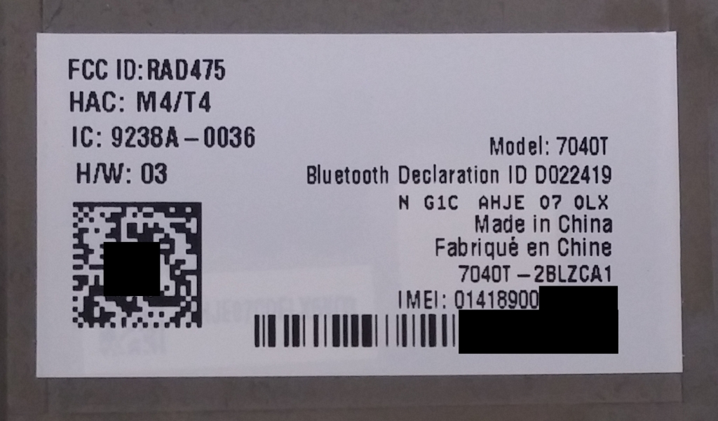

There seems to be submodel number to my 7040T, I don't know if this is significant or not. See pic
My androidboot.bootloader=L6G1V0V0AW0

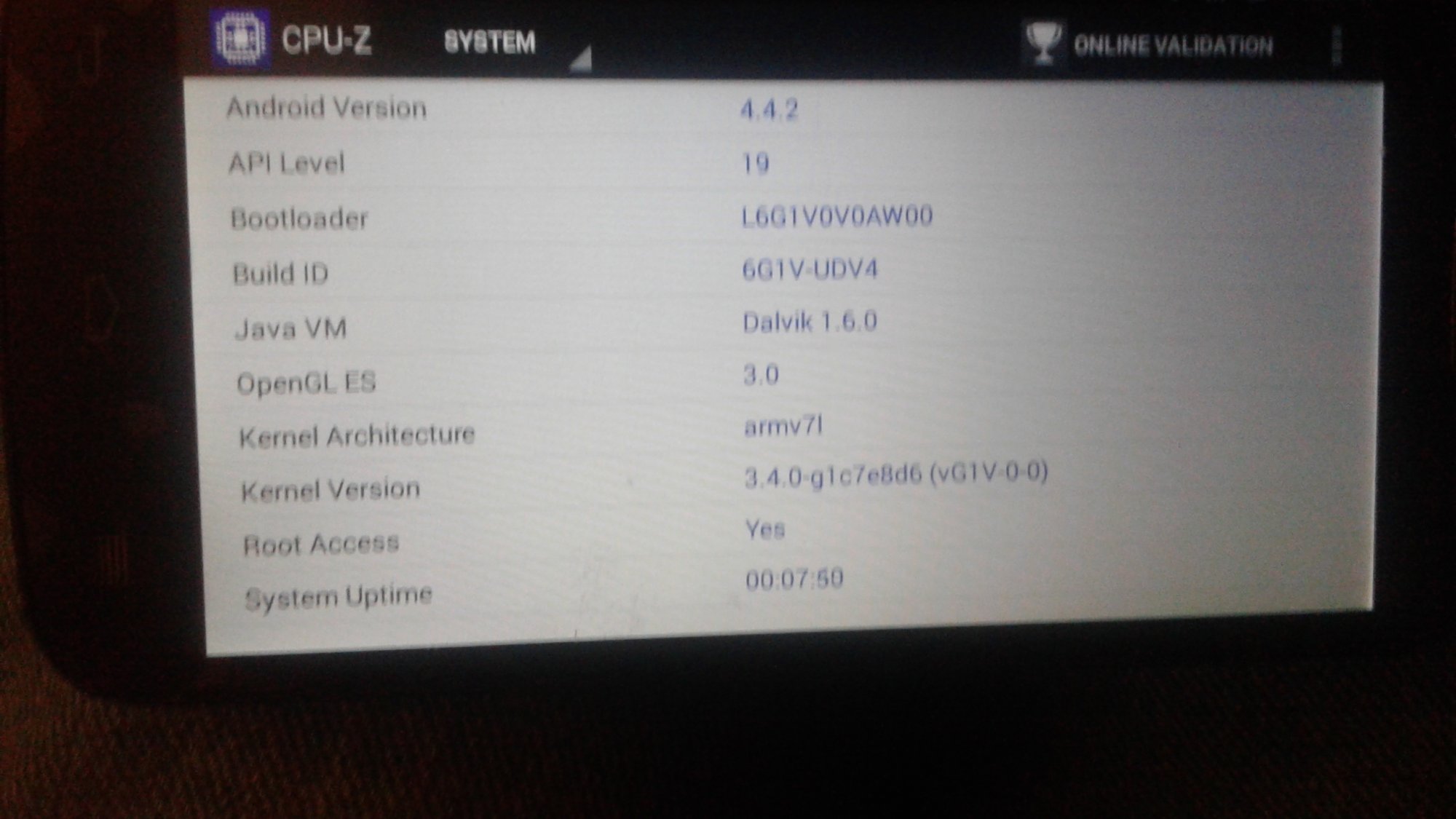

So here is what is driving me nuts.
We have the same phones here. And the recovery is confirmed to work.
But when i unpack and compare boot images I have seen a few different BOOT-LOADER.
There is a correlation between some characters in the bootloader and build ID strings.
