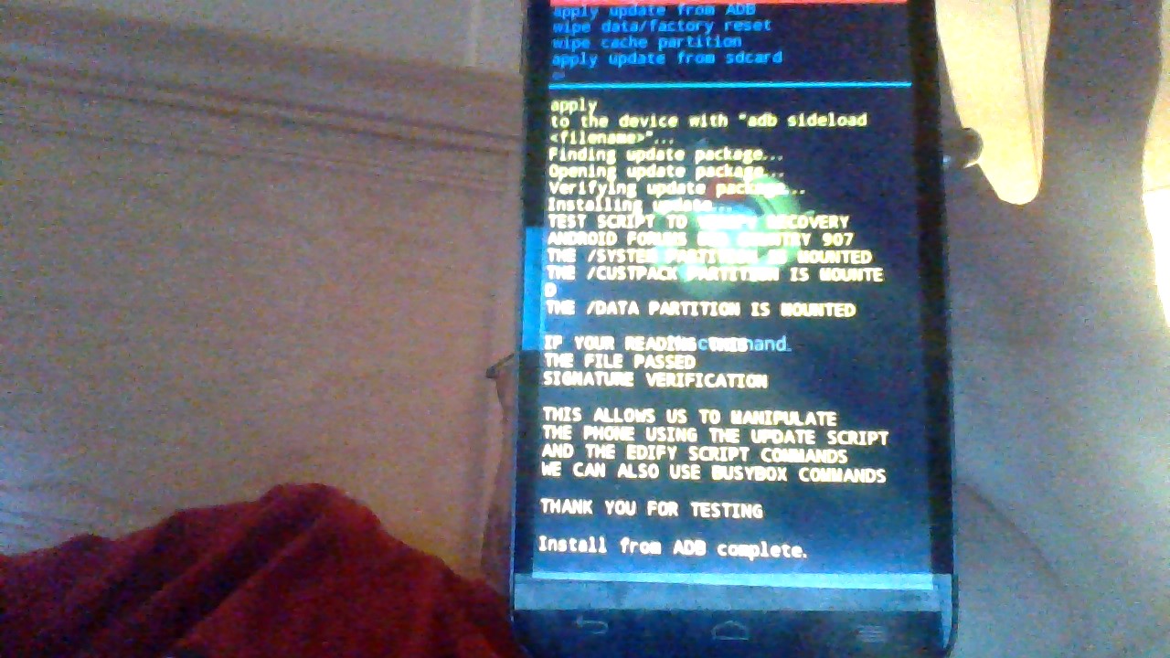

Ok thats good. reboot your phone its still fine. Flashify automatically boots you into recovery after it flashes it.
Here is the test zip for you to sideload. It only displays a message it will not change anything.
https://drive.google.com/file/d/0B8jitdIyh2NtYmZ5bGJsbExuUUU/view?usp=sharing
copy the file to C;\ANDROID\SDK\PLATFORM-TOOLS folder on your computer.
Unless you installed adb somewhere else. You should see adb.exe in the same folder.
To sideload open up adb.
attach phone to computer
reboot the phone to recovery.
in recovery select apply update from ADB.
on the computer in ADB shell
type
adb devices
you should see sideload
if you do
type
adb sideload message.zip
if you dont see any device when you type adb devices
You need to install this driver
https://drive.google.com/file/d/0B8jitdIyh2NtVlN2NEdnRWJTbTg/view?usp=sharing
Just unzip universal driver
double click and install it.
let me know if all is well with the
adb devices
and if you get the messages from the message.zip

test worked great

And you successfully used sideload to run the message.zip.
Can you take a pic of your phone screen and post it up here showing my messages.
I know it works but I think others don't.
If you post a pic they will see.
Then maybe one of the more experienced devs will help me out with my missing symlinks and permissions.
Since they will know this is real and how close i am to a working rom.
@jason39828
So you confirm !!
The recovery boots and functions after flashing to the phone.
YES i confirm it worked perfectly...give me a minute for pic
i know not best pic but hard at the moment...got to step out for a few minutes
Great
Thanks again for testing this out.
Now if I can get the rest of my update script figured out for the rom we will be all set.
Tomorrow I will try to see if i can make an sideload to backup all the partition images so you can do a sideload and get the backup on your sd card to send me.
But in the mean time if you have an hour we can do it with adb.
Thanks again
Great
Thanks again
unfortunately i dont have a big enough SD and cant get one till payday. i have a little 2g in it right now.
about 1 gig will do just fine. Less if you need it to be less.
We can copy a partition at a time and pull it to the computer to conserve space.
What im thinking is if I use dd to make raw partition images that i can flash the images using
WRITE RAW IMAGE
instead of
PACKAGE EXTRACT
By creating Raw images of the partitions and flashing back Raw images Then I think there is a chance maybe I wont loose the Permissions Settings or any Symlinks.
I know when you unzip a android backup you loose files and permissions. Even though I am doing this in Linux it still happens I believe.
The Raw Images could solve the whole problem.
Thoughts Anyone??
