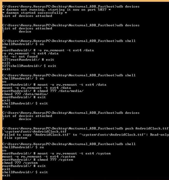

I'm really new to the developing thing and I got my phone stuck on a soft brick. I tried replacing the boot animation with another using adb, but it told me that the directory was read only. Here is the code that I used
adb push \Users\Henry.HenrysPC\Desktop\Nocturnal_ADB_Fastboot\bootanimation_virgin.zip /system/media/bootanimation_virgin.zip
I used this in FTM mode.
I was able to successfully pull the dysfunctional boot animation, but not replace or delete it.
If anyone could help it would be greatly appreciated!
mount -o remount,rw /system
but in the future, dont do stuff like that without clockworkmod or some kind of custom recovery in case these things do happen, then you just make a backup while its working and when you mess up you just hit restore
Thanks for the quick response Junkie, but I tried remounting the system in adb shell and in adb shell: su
either way when I tried to push files afterwards I got the same error message, and I'm sure I had root access when the phone soft bricked.
How would I flash a new ROM, if that is possible without clockwork mod
Thanks for the guide Stevie, unfortunately it did not fix the problem. I get the same error. I there anything more to be done or is it a lost cause?:(
