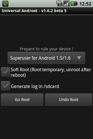

1) search the app "Universal Androot.apk V. 1.6.2 beta 5" on your devour's google browser.
2) find a credible link and download and install the apk.
(It should look something like an orange un-locked lock on your desktop)
3) Open the app. It looks like the attached picture.
4) Make sure Superuser for Android 1.5/1.6 is selected and soft root is not checked. also be sure to check generate log in /sdcard. Trust me. everything will run smoothly if you do.
5) Finally, hit Go Root and let it do its thing.
