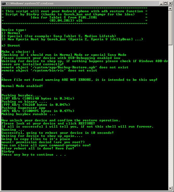

I've tried multiple steps and end up with the same thing:
attachment.php
Tried both 1 and 3 with same specs but software version LG730ZV6. Doesn't seem to work for me. Using method 3 it just hangs after
[HIGH]After restore is confirmed please look on your device and choose "Service Tests
-> Display" in Service menu and WAIT THERE!"
Starting: Intent { act=android.intent.action.MAIN cmp=com.sonyericsson.android.s
ervicemenu/.ServiceMainMenu }
Error type 3
Error: Activity class {com.sonyericsson.android.servicemenu/com.sonyericsson.and
roid.servicemenu.ServiceMainMenu} does not exist.
/data/local/tmp/onload.sh ...[/HIGH]
