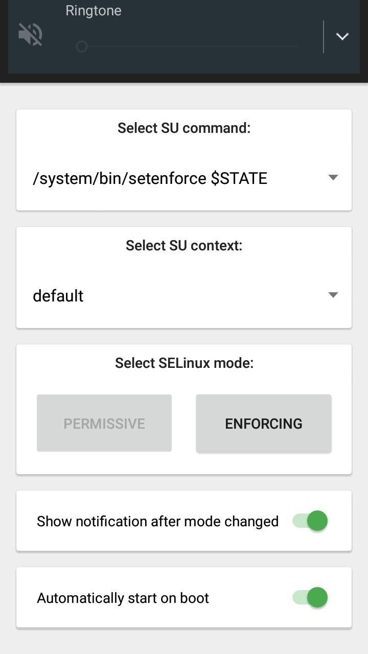

does this ROM/kernel have init.d support? I've read elsewhere that you can use a script to auto setenforce 0
Create script as follows:
Code:
#!/system/bin/sh
setenforce 0
(Note: If you're using an app to emulate init.d, use su -c setenforce 0 if just setenforce 0 doesn't work)
Save it as set_permissive.sh, move it to /system/etc/init.d/ directory and give it permissions 755.
ofcourse this is all assuming you've got a way to make things stick which is what we want...
if we can get things to stick we could add this:
Code:
ro.build.selinux.enforce=0
to our build.prop
so for now, do this:
Code:
su
setenforce 0
then try mouting the system as rw? hope any of your changes stick, also, look into dm-verity

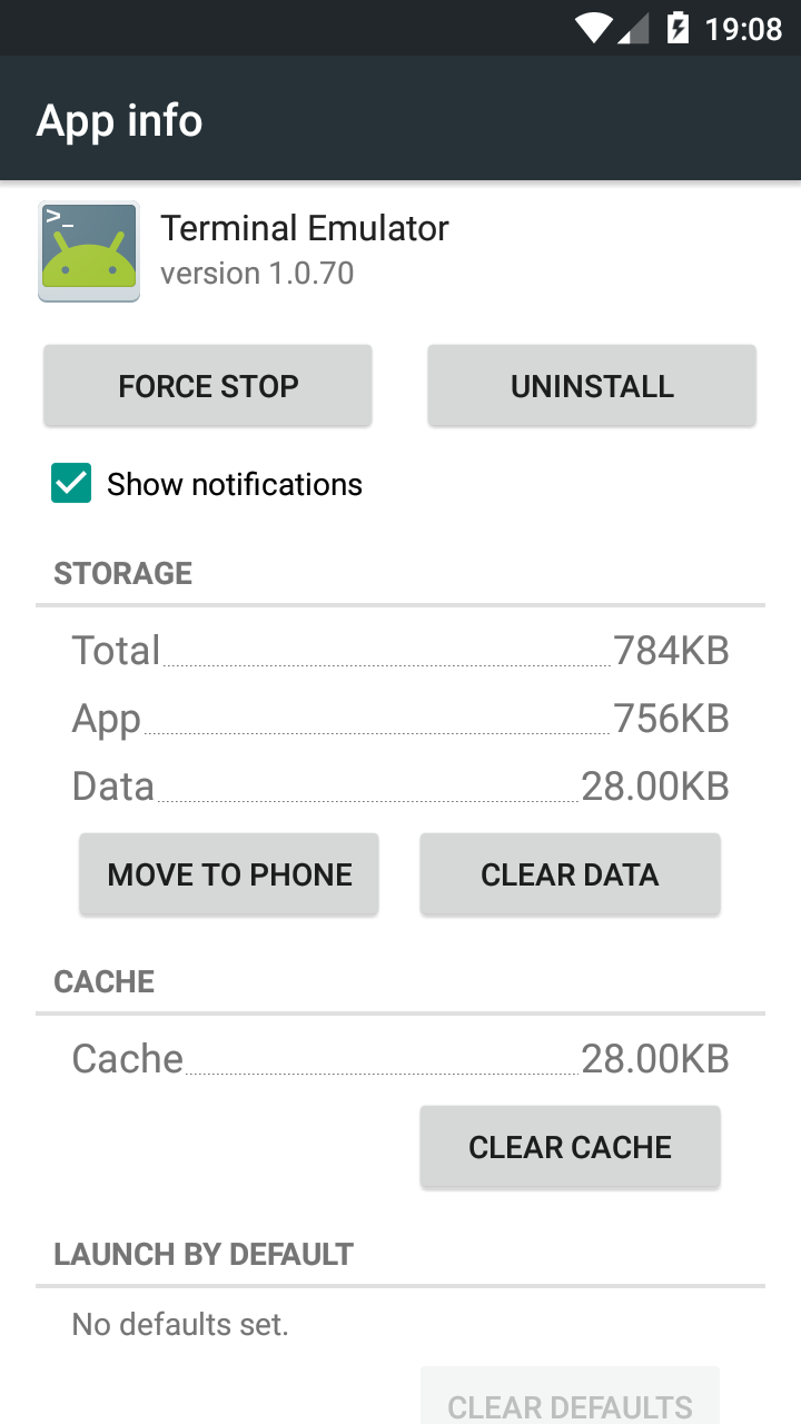

This is a good, light weight terminal emulator you can get at the Google Playstore.

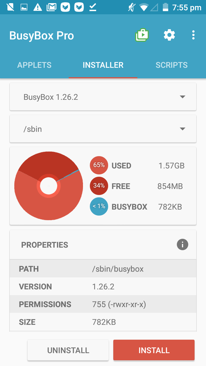

2. Install Magisk Manager(v 7.4.0), Root Checking Software (Root Checker off Google Play), and, optionally, BusyBox (I used BusyBox Free).
