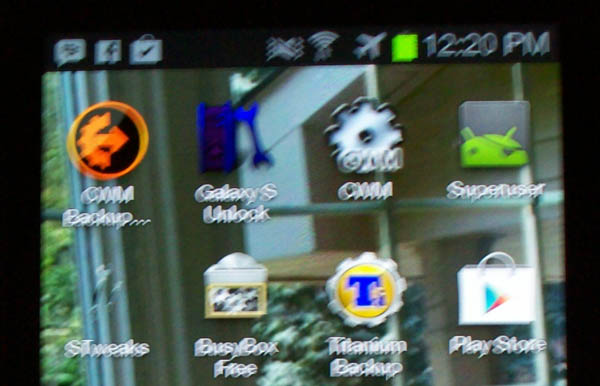

Have you got CWM and Superuser in your app drawer?
Yes they are there from the 'supposed' root.

Here are two screen shots.

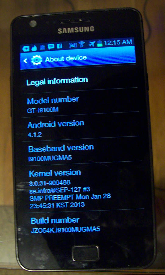

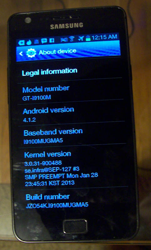

1) The ATTACHED IMAGE is an OLD screenshot of my version before I tried Siyah and supposedly rooted it.

3) Also just tried to rooting it again using Odin with the above Siyah Kernel, it seemed to work in Odin (gave me a pass), but Root Checker and Titanium backup says it is STILL NOT ROOTED
4) CWM manager says "This version of CWM manager should be used with CF-root v5.0 or newer. It appears you are running a different kernel. Various features have been disabled".
Verdict : NOT ROOTED

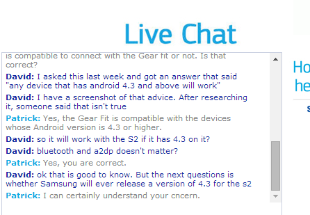

oh crap, I was told by the lady at Samsung that is only needed 4.3 (this was via an only chat).
and was just told again by a new agent that the S2 would work if it has 4.3 on it. I took a screen shot of both conversations...

The Samsung Galay S2 is now 3.5 years old and reached its EoL, (End of Life), 1.5 years ago with the last official release being Android 4.1.2. There are and will be, no further official updates or support for this model to Android 4.2.2 or Android 4.3. Whilst there are some custom ROMs available for the SGS2 that show Android 4.4.4, NEAT ROM for instance, these are custom AOSP ROMs that are heavily adapted to work with the S2's hardware. The first model of phone to receive Android 4.3, (which was designed to support the Gear), officially, was the Samsung Galaxy S3.
