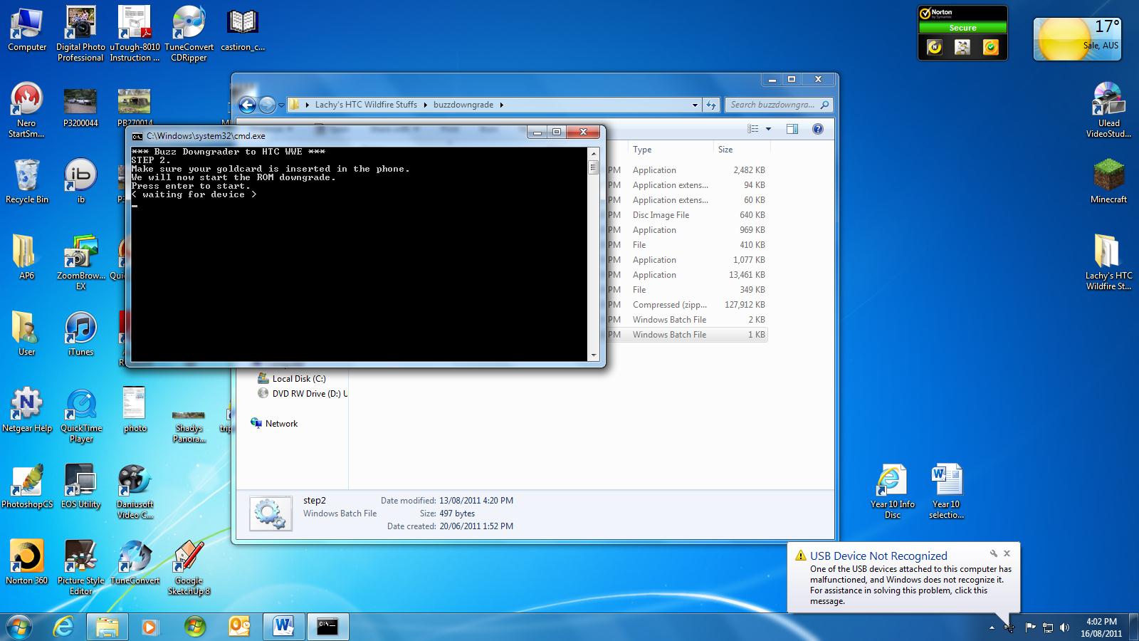

I did what you said but it stayed on "waiting for device" although this time in the HBOOT it loaded a ZIP file (I can't remember the name) but I can't find anything that has changed. Is this what is meant to happen? Or what have I done wrong? Sorry for my noobish questions
Ok where exactly does it say "waiting for device"?
1) In command prompt on windows (the black screen with white letters and numbers)
2) When you open the "RUU rom"?
Take a printscreen of it and attach it to your next post
So the first time I plug it in and open "step2" and click "enter" it says this -
So I restart "step2" and press "enter", then it works -
But the phone stays on this -
What am I doing wrong?

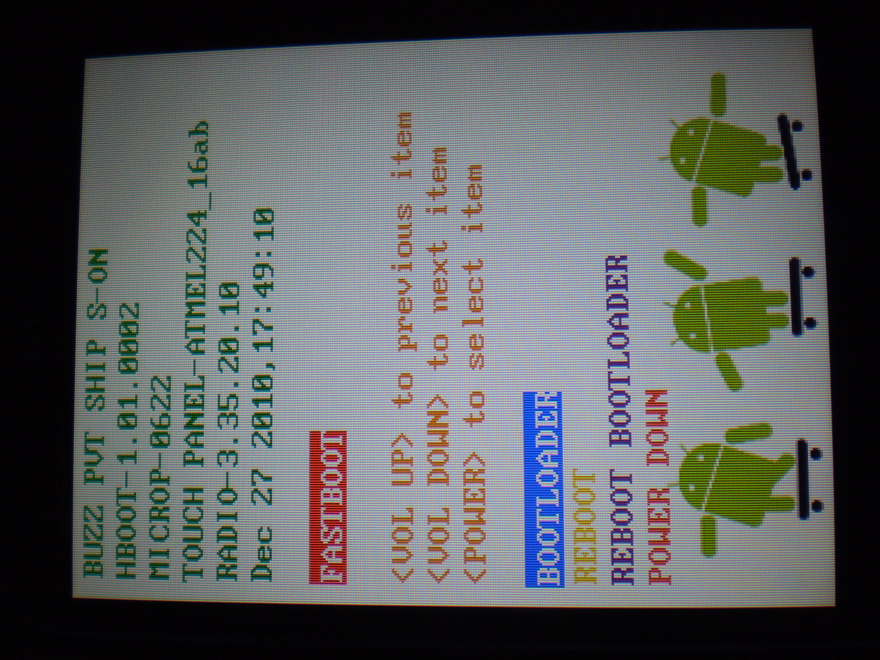

Dude you still have hboot 1.01.0002.
You gotta start from the beginning where you downgrade to Hboot 1.01.0001
It's impossible to turn s-on off with 1.01.0002

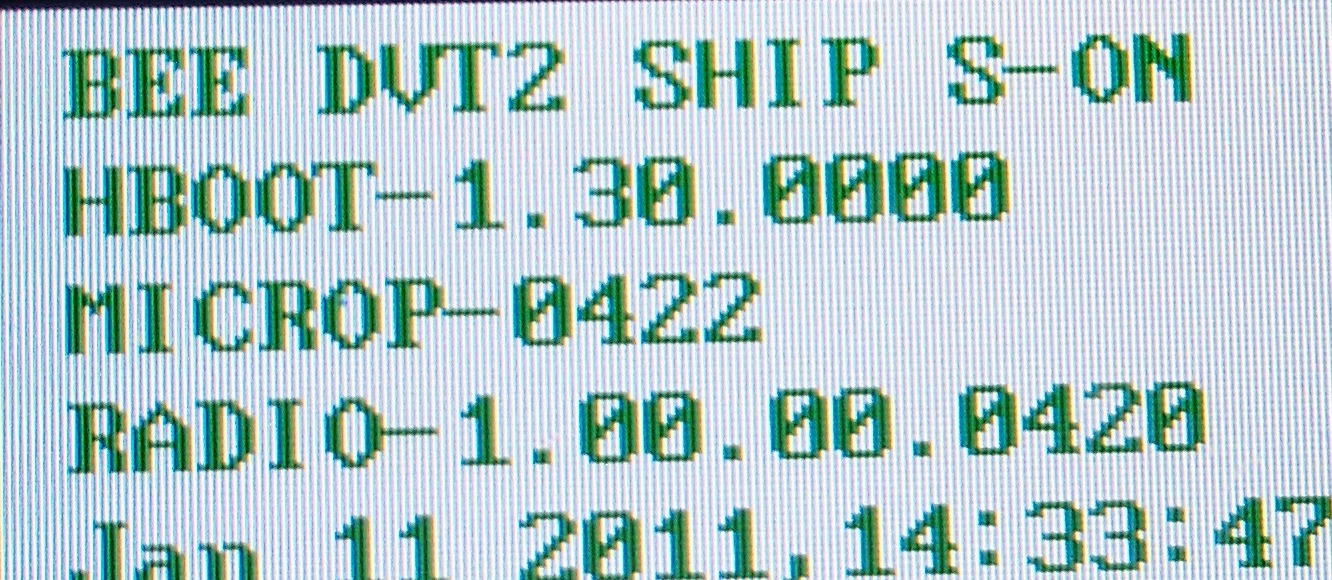

i have an htc wildfire bee it has hboot 1.30.000 and i cant get s off i have tryed this method but i havent had any luck it does go through the boot and everything but when it loads back up it is still s on any ideas?
i was able to root it though but cant get s off..... :( :( :(
Hey dude
I was kind of confused about your htc wildfire bee but then i realised that you have the US version of Wildfire and i have the UK version, also i have never heard of a Wildfire having a hboot of 1.30.000 only the EVO 3D.
Could you provide a picture of your Wildfire when you have your hboot up?
I dont have any solutions for you but ill keep you posted if i do

ok sorry it took so long but here is the pic of my boot screen with the 1.30.0000 boot

i rooted my htc bee before u said that i found it out a long time ago just cant get s off and i think i need it off to install custom roms
