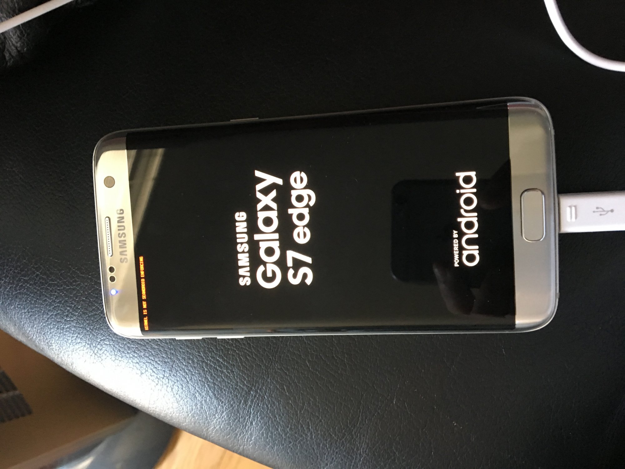

hi there i just purchased a new galaxy g935f international version. definitely need some help here regarding firmware! i recently rooted the device and everything was running extremely good until i restarted the device to free up some ram and run the stock cleaner.upon restarting it the screen is stuck on the initial screen (will not go to the samsung logo) however it connects to odin and the only thing i can do is press the 2 vol keys up and down and put it into download mode so what i need is the proper firmware version for this phone i have been looking and there are tons of versions available no where on the device nor box gives me the info as well i feel that if i have the correct version i can restore the device back to normal again using odin smart switch will not work as well i really need some help here regarding this and any feedback would be greatly appreciated! this phone kicks ass and is wicked fast

Hello and welcome to Android Forums vito8486 :)
The only certain way to determine which of the 200+ stock Samsung firmwares came with your Global, G935F, model is by accessing the CSC and Product codes, which is not available to you as you cannot boot up
Which country and carrier are you with and was your stock firmware carrier branded?
im in the usa. and i did get the phone registered and anew sim at att i switched the sim out from my iphone 6s as they are different phones and have different networking thank you very much for the reply!!
OK... you have a grey market phone that was not intended for sale in the U.S. and you cannot access which of the 200+ global firmwares it came with. Therefore, you may as well, since there is no U.S. firmware for the G935F, download and flash the stock Samsung unbranded firmware for the U.K. See, below. Once you have flashed it and the phone is running, you can install, free from the Play Store, Phone INFO ★Samsung★ and run it. Under Product code, you may be able to determine your original Product code and use that to flash the correct firmware that will allow you to receive OTA or Smart Switch updates.

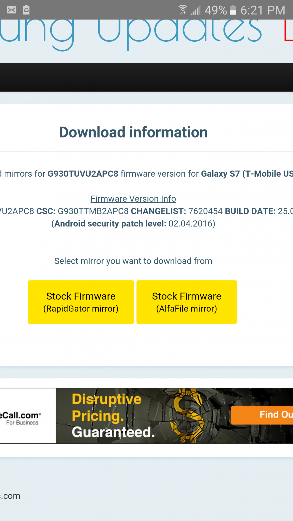

Never mind the gator one costs money to download lol I guess I'll just wait till it's pushed to my t-mobile carrier for my S7.
You can also use a PC & use Samsung's Smart Switch or KIES3 desktop tools to d/l & push the update to your phone.
