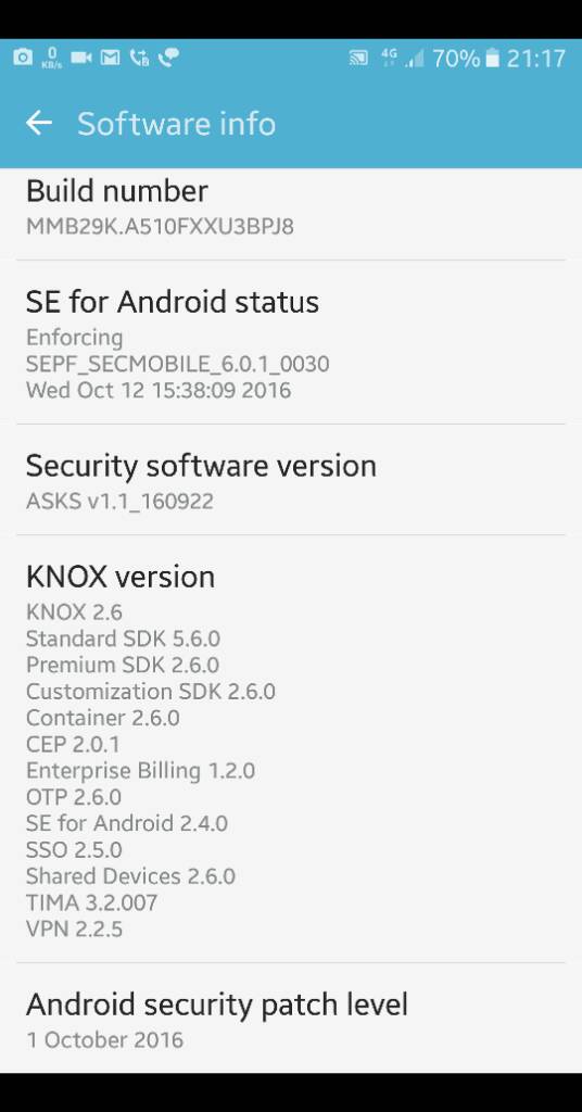

Not after OTA 6.0.1 , but Samsung Releases a security patch every month to my phone(s). But after the September update, all this issues started. Is there any connection with these ? After that i recieved October update too... But the problem is not solved. November update is not yet received.
