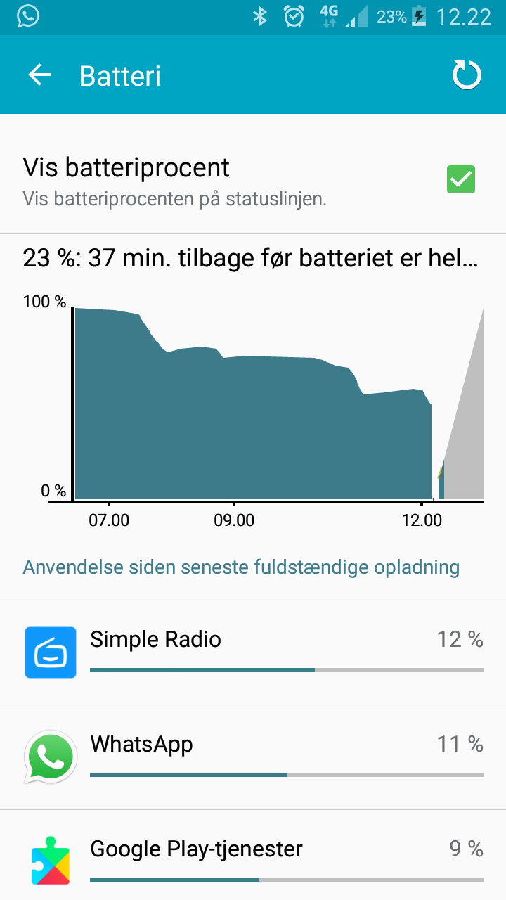

Here's how I observed the sudden shut down, see the attached screen shot just after I re-started the phone and had it started to charged.
Had 43% power left (according to screenshot) when it went black, without any warnings. I did not install new apps for a while, but of course accepted updates of existing as per usual Play Updates..
Went from my 4400mAh battery, back to the original 1860mAh one, and after I charged it to 100% I rebooted phone.
After some radio listening over 4G mobile network, it went black again. I started to charge, and it went up to a start level of around 50% or so, and began charging from there. Then booted phone again, and had it online for a while, then I used it for GMaps and drive directions. Then boom, after 10 mins it went black again...

The problem you're experiencing is different from mine. My device is warming up and restarting. You have a sudden charge drop. I can tell you that both of your batteries may be a problem or they may be caused by the power chip of the device. I can help you so much.
