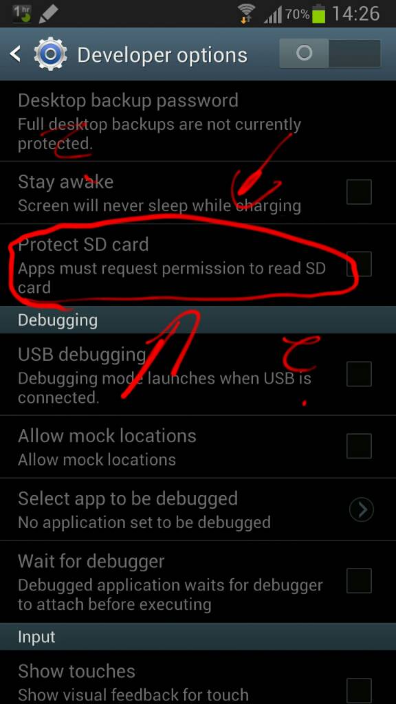

i have an answer!!!
spent an hr on the phone with Verizon & Samsung
I've gone through 4 sd cards... n ..this morning my 32gb sandisk Ultra card failed too..
The process was long... the fix was simple ..... DON'T FORMAT!!!!
GO TO SETTINGS
- DEVELOPER OPTIONS
- CLICK PROTECT SD CARD BOX
done ... all info was restored to my sd card.. no formatting needed!!

Can you better spell out exactly what was wrong with your card and how this fixed it?
Are you supposed to leave it checked now? If so, how does it effect using the phone? Do you have to permit access every time you run the app that accesses it?
Who told you to do this, a Verizon or Samsung tech? I'm not in any hurry to enable an option like that with out knowing exactly how it works.

Samsung tech ..gave me the info.. after a few other tries..
this was my 4th or 5th Sd card..
all of my cards ..I had believed to be garbage..
Just try it... if it works fine... if NOT o well.. best of luck to you.
Samsung tech said.. card gets to hot with all my 50apps trying to access bits of info from it in the bank round.. our something like that.

Mine doesn't have that option.

Tried this after seeing the post. It didn't help. My card still regularly flakes out. (My card has never totally died, but I'll go to use it, like play music stored on it or view pictures stored on it, and it comes up empty. I go to My Files and into the external card and shows the card but shows "No Files". I go into Storage settings and unmount the card, then remount it. Sometimes I have to do this 2 or 3 times and then the files finally show up in My Files. I can use it right then, but by the next time I want to use it after that, it has flaked out again. Really frustrating. I'm about to the point where I'll be taking the phone back to a Sprint store and asking it to be fixed or replaced under warranty.
