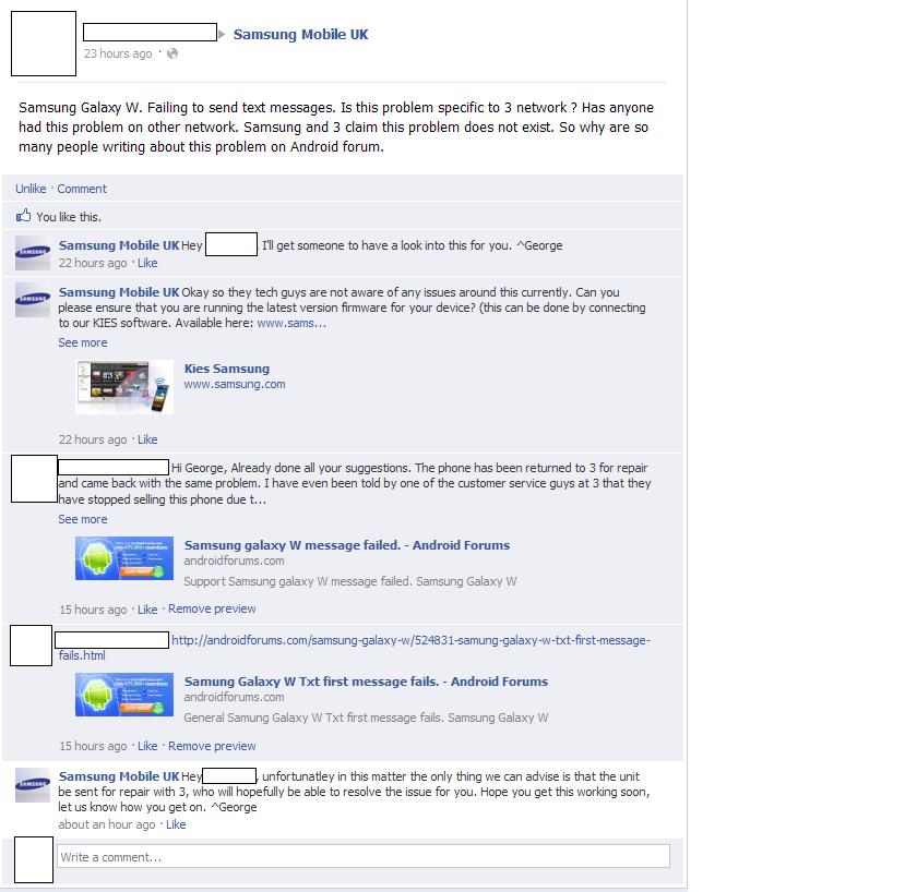

My conversation with Samsung mobile uk on facebook.Waste of time !!!!! Please have a look at the attachment.

At all pages hete u raad this problem is 3 specificaties and in the UK..
But i have my sg w, now almost 5 months and i live in belgium..
Network = Base..
Suggesting it would be a software issue..
