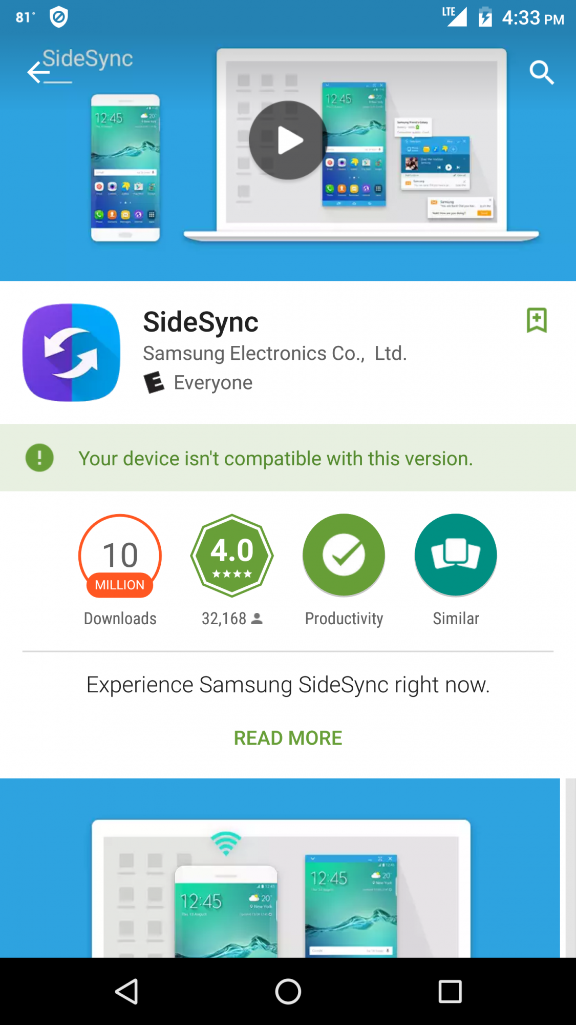

Something else that may be useful that I have seen recommend here for Samsung devices with broken touch screens.
SideSync is a app at the Play Store that along with the pc software will allow you to see and control a Samsung devices with a mouse.
Not sure how it would work with TeamViewer but worth looking into.
I suck at posting links to the Play Store but this is the app

Hmm.. Sidesync appears to be the same type of application as Teamviewer except that it only works with Samsung devices. Thanks! I will have to take a look. May be it will work better than TeamViewer.

My idea was that if SideSync was installed on her phone and PC, all she should have to do would be to connect phone to pc via USB cable and open up SideSync. Then you would be able to have direct access to her phone from a remote location via TeamViewer to change settings if needed or to move anything to SD.
Haven't tried it but sounds like it should work.
Instead of talking her through making changes on her phone, you would be able to do it remotely
Using Team Viewer on two PCs and Side Sync on the remote PC should work just fine.
I have done both, just not in that manner.
