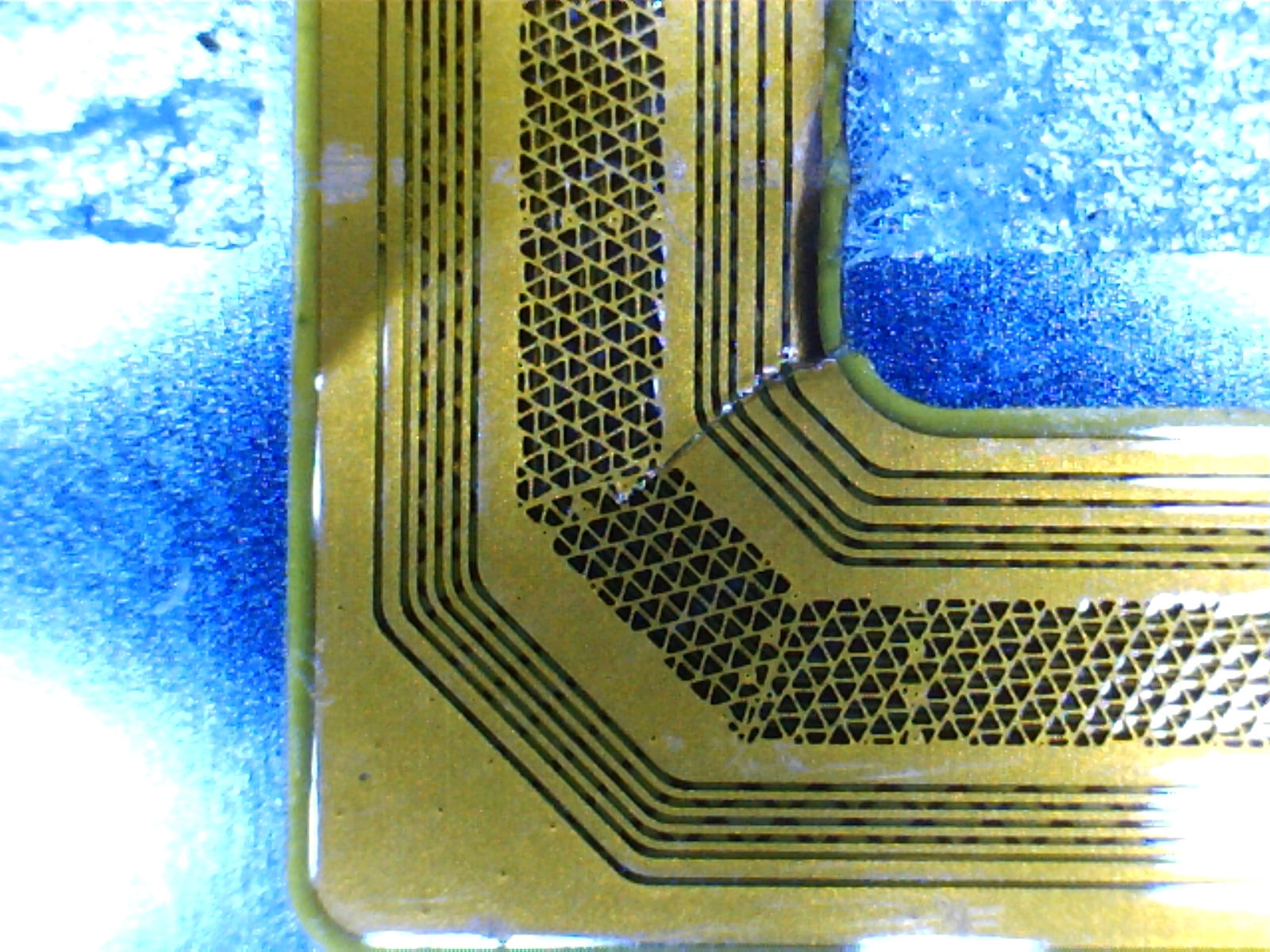

I've just acquired an HTC Vivid/Holiday/Raider hat vibrates every 15 seconds, nothing else.
The previous owner had a go at changing the digitizer and after which it did not work.
Looking over it, I have found the LCD cable has a tear in the corner.
The picture I have attached was taken at 20x with a USB microscope.
Due to the wire size, repair is extremely unlikely.
I have ordered a new LCD which I suspect will fix the problem.

I had the same problem. After replacing my cracked digitizer with a new one the screen would no longer power-on/light up vibrating every 10 seconds. I then replaced the LCD screen and voila, phone saved!
My guess is the vibrating must be some kind beep code similar to a computer. I looked all over the place and couldn't find anyone who replied to one of these threads. I hope this helps someone else out. Good luck.
