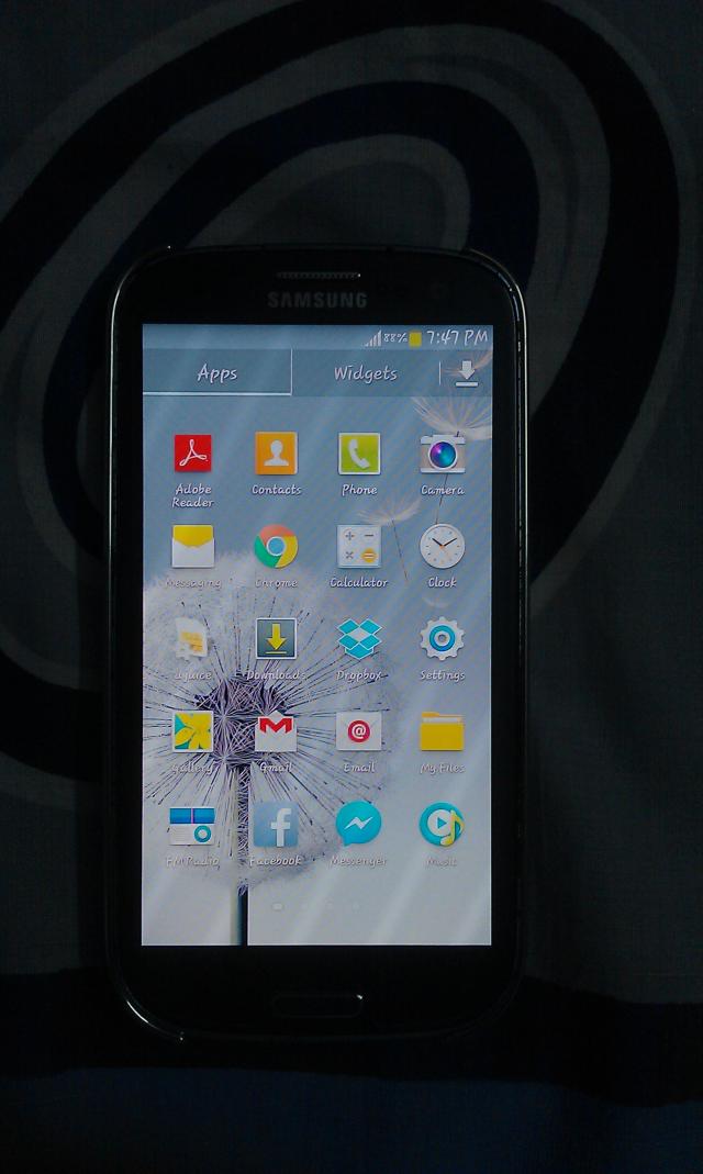

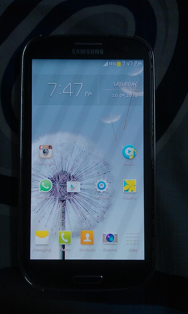

I know that this thread is old but i have same problem. I have attached pictures of how my screen looks vs the screenshot of how it should really look and also attached the Black box image test found here.
Black level - Lagom LCD test
and how it looks on my S3 and what happens when i pinch to zoom out.
So anyone found a software fix for this or do i have to replace my screen ??

Hi! Well, my screen used to get this washed out aspect of yours and, as you may have read here in this thread, my solution was to replace it. Have you tried resetting your phone? I think it would be interesting to do that before actually replacing anything. In my case, it was really a hardware problem, so I had no other choice but to replace the screen.
And just out of curiosity, did your screen gradually got washed out or was it out of the blue?
I got my S3 last week from someone i know in this condition. he said it happened out of the blue i think when he once dropped it. the day i got this set, i tried to tweak some contrast settings with help of some different apps but nothing made it better so i let the phone rest for a bit and later when i picked up the phone, the colours were perfect and all fixed. The display was flawless for a couple of days until today the issue came back out of the blue when i unlocked the screen in the afternoon. i tried restart, taking out battery. I even opened the set and tried cleaning the LCD Contact on the motherboard but nothing worked. I'll try factory reset tomorrow. I'd like to know even if there is a temporary fix.
I'm sorry, but I couldn't find a temporary fix for this. I do remember that the colors on my screen used to get randomly perfect, only to get washed out a few hours later.
Please try the factory reset and then come back here to report if it worked. I really hope it does!
Firstly, Thanks for the help.
However, Factory Reset didn't work either. My friend said the LCD must be pressed out for this to happen.
Also, u said your colours got randomly perfect. How often did that happen??
First of all, I'm sorry factory reset didn't work.
About the colors getting randomly perfect, sometimes they would stay that way for hours, sometimes for minutes. As to how often it happened, as I mentioned, it was random. But the bottom line is that after a period of time, the colors didn't get back to normal at all. At this point, I made a few tests on my screen to make sure it was really the problem and then replaced it.
