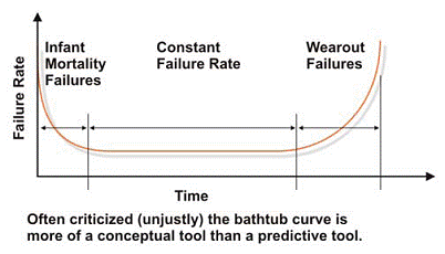

Also I guess you don't know of the bath-tub curve of newly made items?
See image.
When a item is first used it is most likely to fail in the first 3 months and then if it passes that, it'll last for years until it reaches the end of its service life span.
As an engineer it always amazes me how many people think everything they buy should work perfectly from day one. Just doesn't happen in the real world. :)
