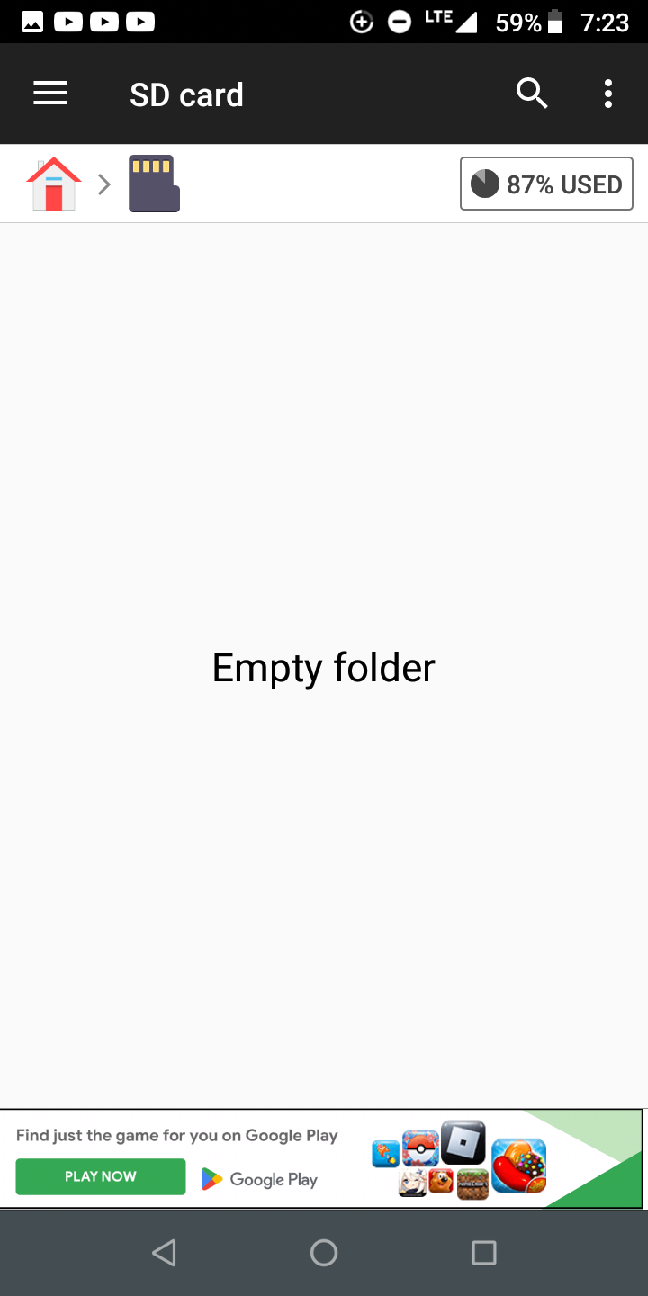

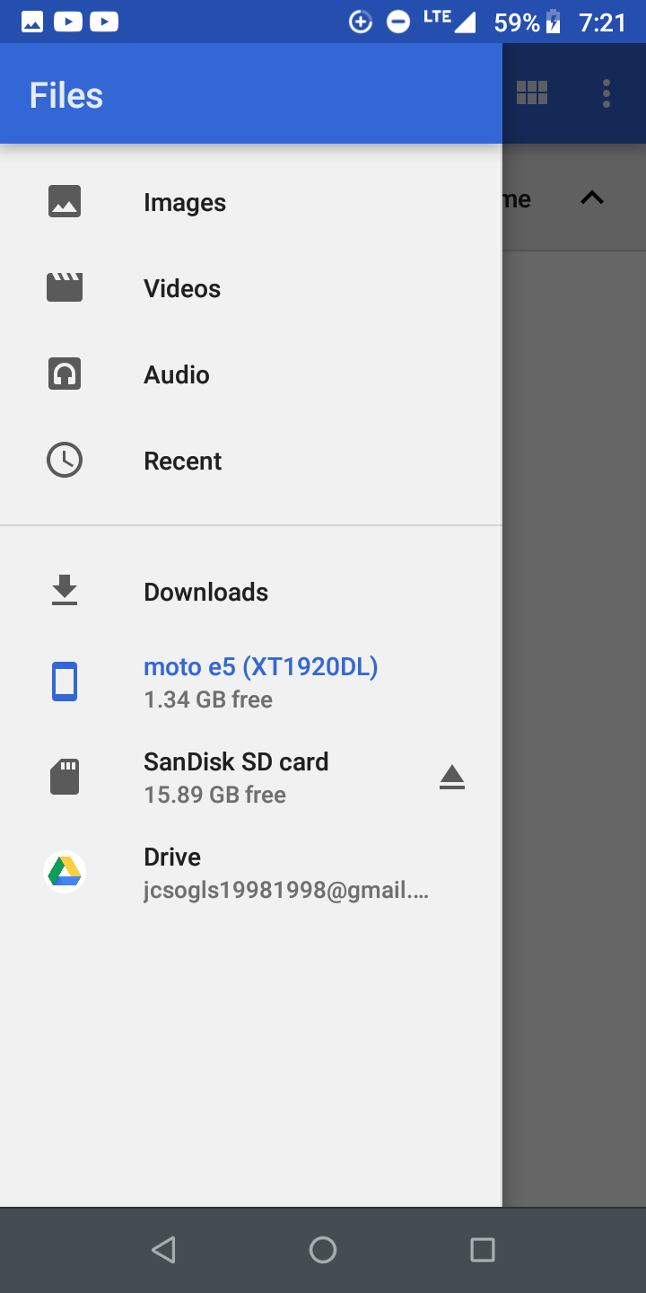

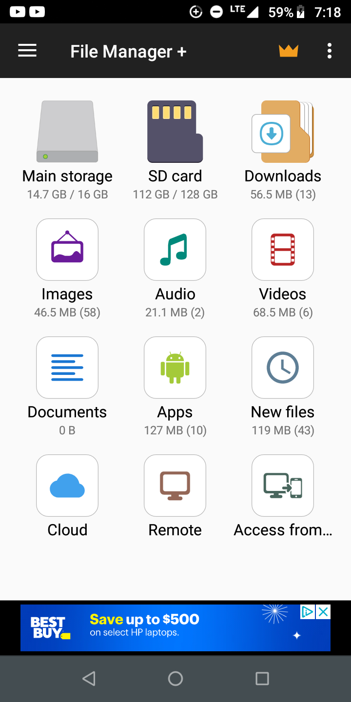

I recently started a thread about a problem I was having with backing up my phone. Well I have a new problem now. Out of the blue I go to access my sdcard through my file manager And all of my folders and files are gone. However at the homescreen it states that 87% of the sdcard is used and has content on it or 112gb of 128gb
Is there a way to fix this?
