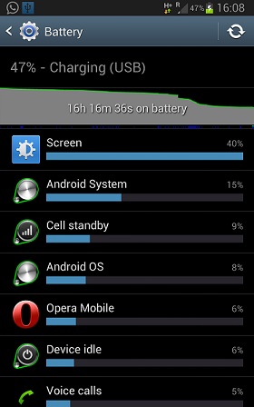

It's 8:50 hours since I took my phone off charge and with WiFi, Bluetooth and Mobile data disabled (and some apps frozen) it is still showing 100%. This is the original, 16 month old battery.
EDIT : I turned WiFi on just prior to taking the screen print because I wanted to upload the screen print from the phone to my laptop in order to post here. It had been off for the previous 8:50 hours, because I've been at my laptop and had no need for the phone to be doing any data related activities like getting email, surfing etc..
Having enabled WiFi, downloaded a couple of queued apps, taken the screen prints and uploaded the files the battery did drop a couple of %, so it was barely clinging on to 100% when I took the screen prints, but there is no way the battery should be collapsing at the rate your does unless it is well and truly f....d.
