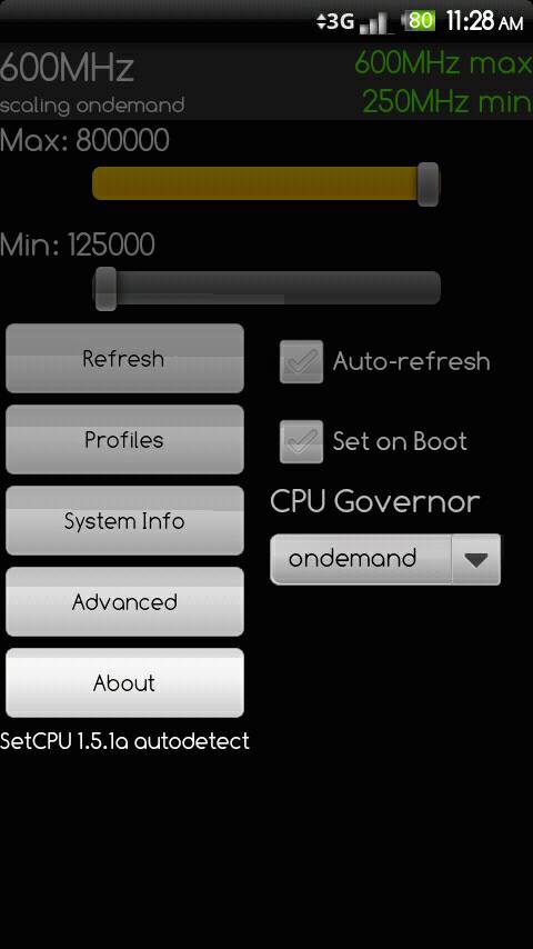

A little confused. I have the 800 kernel loaded but this looks like I'm running at 600. I did the autodetect.

You have the governor set at ondemand. The phone is running 600 currently, but will switch up to 800 as it is needed or lower as needed. This saves battery. If you want it pegged at the fastest all the time, switch it to performance.
Your SetCPU is set for the "on-demand" setting... that means it will scale the CPU speed according to what the phone needs for the processing its doing in order to save a bit of battery. If your phone needs the extra speed, it will scale up to 800 as needed.
It says 600 max though. I suggest moving the slider down a little, then all the way up again.
Also, doesn't hurt to check the 'set on boot' box :D
Ah yes! Much better! Now that makes sense. Thanks!

I didnt set any profiles in there yet. I wanted to see why it looked so funky first. It appears that just sliding the slider and back made it show the correct settings. Now I can assign the profiles. I appreciate everyone's feedback.
