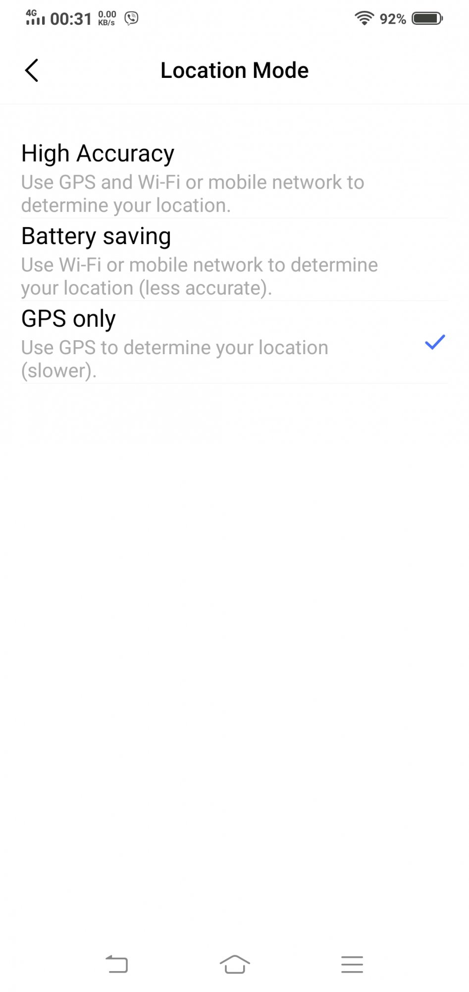

I can't speak for your specific device but generally speaking, from version 6 Android takes battery consumption very seriously. Many background services like GPS could be killed when the device's screen is turned off.
You should try to explicitly use GPS for location in the settings menu.
For example on my phone I need to select GPS only to keep it running, despite it sometimes I found that the GPS turns off itself when battery is low.
Also keep in mind that GPS needs good signal to be fully functional. There are many locations in a house or a building where the signals are so weak that it becomes almost useless.
I have been looking for the Location Settings you mentioned on my Android 9 phone, but can not find any GPS Only setting. The closest thing I could find were some settings under Location -> Improve Accuracy and I unset the wifi and bluetooth scanning. Perhaps that is the equivalent of GPS Only on this phone. I will see if that takes care of the issue, although presumably the wifi and bluetooth settings are supposed to improve accuracy.
