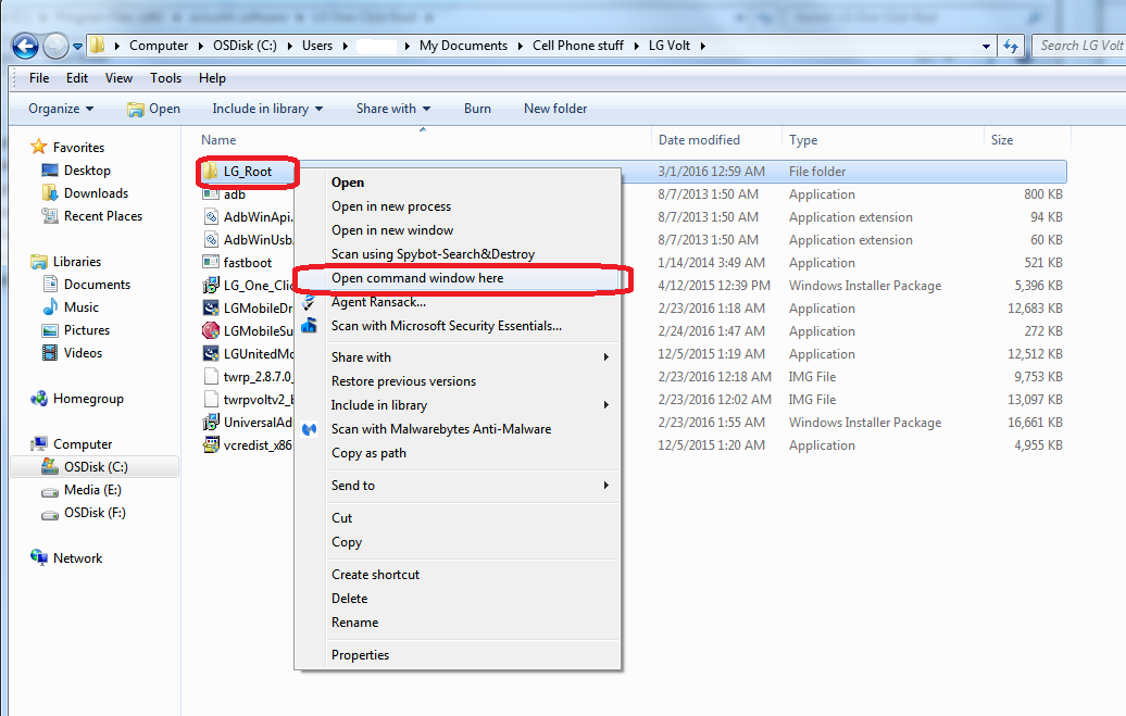

Woohoo! I got my phone back!! :)
It turns out that it was a permissions issue on the /system/etc/mixer_paths.xml file. When I copied this file back to /system/etc using ES File Explorer after editing it on my PC, the permissions were different than those of the other .xml files in /system/etc. For whatever reason, this stopped my Volt from booting all the way up. Once I changed the permissions to 644 using the busybox chmod command (or was it the Send_Command.exe chmod?), my Volt was able to successfully boot.
I put my Volt in download mode by pressing Vol+ while plugging in the USB cable. I then ran the Send_Command.exe that LG One Click Root runs during the rooting process.
Now, my next job is to install TWRP Recovery now that I'm able to :).
Edit: I should mention that I didn't have to do a factory reset to reflash anything... just fixing the permissions on /system/etc/mixer_paths.xml got my phone back the way it was.
Edit 2: Please disregard the attachment at the bottom of this post. I posted it before realizing that I used LG One Click Root's Send_Command.exe instead of one I found in an XDA thread. Mods, please delete it if possible... thanks!
