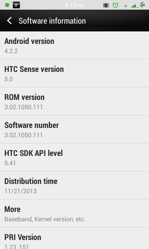

oya? the htc one sv is listed as 4.0 on the cricket website. good deal then!
I bought it expecting ics...was bummed but I was gonna root it and the works, figured there would be some roms available.... so ics was gonna be temp, at least I thought.
Got it and realized it was 4.2.2 woohoo... but yucky white. Good thing too because there are barely any roms. Good phone though. Needs an oc kernel... *looks at cdz* ;p
