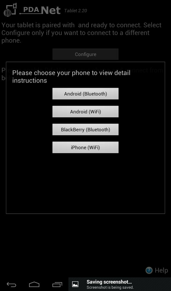

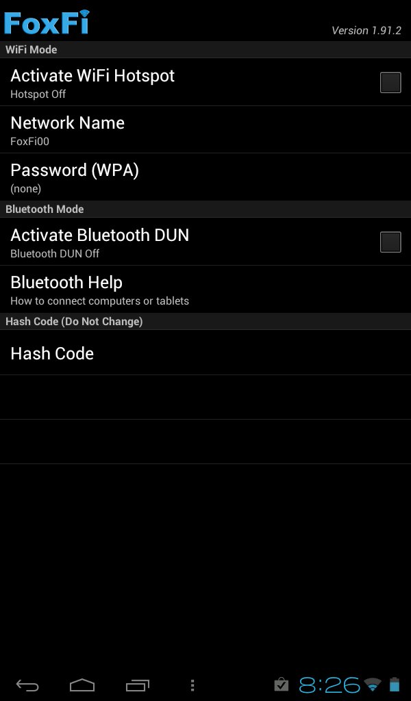

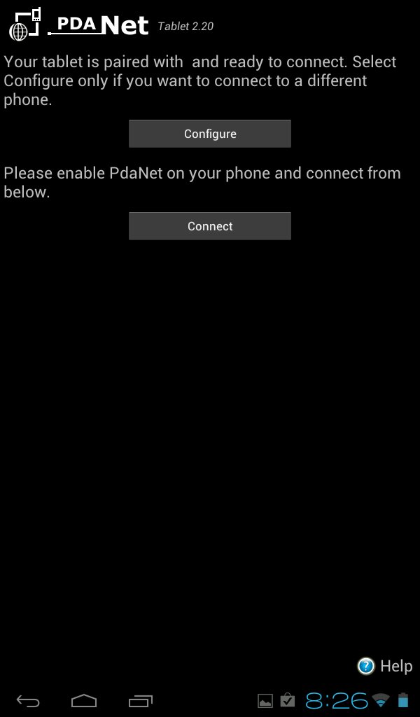

try sideloading foxfi on your phone...... and connect.... and downloading pdanet on your tablet...... if you cant connect with your wifi hotspot you can use foxfi... and pdanet...
1 turn on foxfi hotspot (and foxfi should pop up in your wifi..
if that still doesnt work
turn on foxfi bluetoothDUN
and on your tablet click on android bluetooth.. and the rest of the instructions are self explanatory
here is what it looks like...from a galaxy tab 2
