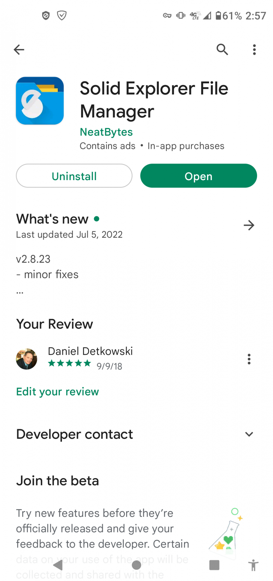

Well if all else fails you can always transfer files wirelessly using Solid explorer, which is what I use on a daily basis. Movies, documents, mp3 files all transfer with no issues.
