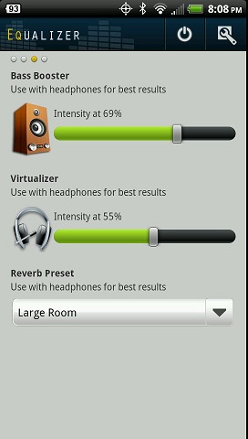

Use equalizer, it is excellent, much better then volume+ IMHO, I had both, and found Volume+ to have way too many options with the sound, and I had no clue what tose the settings on, equalizer is a hell of a lot easier to use, and it works a lot better, I can hear my phone loud and clear from another room, highly recommend it!
I tried EQ and did not find it be any better, post your settings, I had it set on custom, and had all other settings as high as they can go
attachment.php
attachment.php
I tried this as well and noticed that the EQ only cuts the frequencies and doesn't boost them, thus not making the volume any higher. Hopefully somebody gets the Beats software and makes an apk out of it :)
Weird, I've been using EQ for a while and it helps a lot; I find myself turning the volume down when I'm in the office since it's too loud with the settings set to high.
