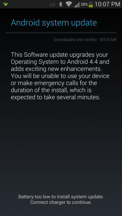

hello all, I have the sprint s3 its has been rooted for a while, I've been getting this message about ota from sprint I tried to avoid the update but noticed my google play does not see my phone any more plus a couple of other things so I figure take the update. The phone will not take the update I get an error. How can I get the phone updated and keep my root and not have to re-root the phone or re-root my wifi mod or lose anything? I attached screen shots of the phone current info as well as the update image. let me know if anything else is needed? thx

2. You actually tried to install the OTA, right?
yes tried to install but it did not work gave an error
"invalid command argument"
then option to reboot
then on phone notification screen
I keep seeing system update downloaded touch to install
