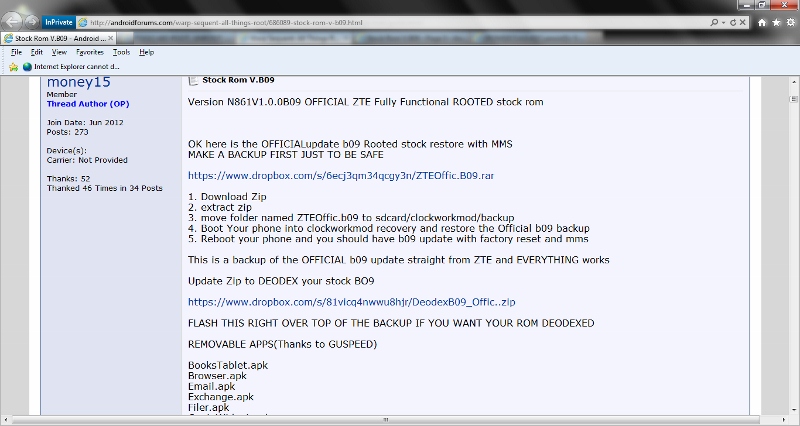

@money15 awesome, which one is the official downloadlink for the ROM the first link or the second link in the image? Untitled (800x426).jpg

Hey, most everything in b09 was fixed. The OTA update is fine. Same goes for money's b09 stock backup. I believe there the same stock B09 roms. The incomplete b09, mms, play store issues, etc, was released early by accident by zte via the update tool. But they fixed that too. Just so people know, the OTA update is a working b09. I don't even think there is a copy of the non working b09 lying aroud here. B09 is ALOT better then B07. Snappy. Quick.

You don't flash superrs zip over my backup...in the first post there is an update zip that will deodex your rom for you if you are not deodexed
