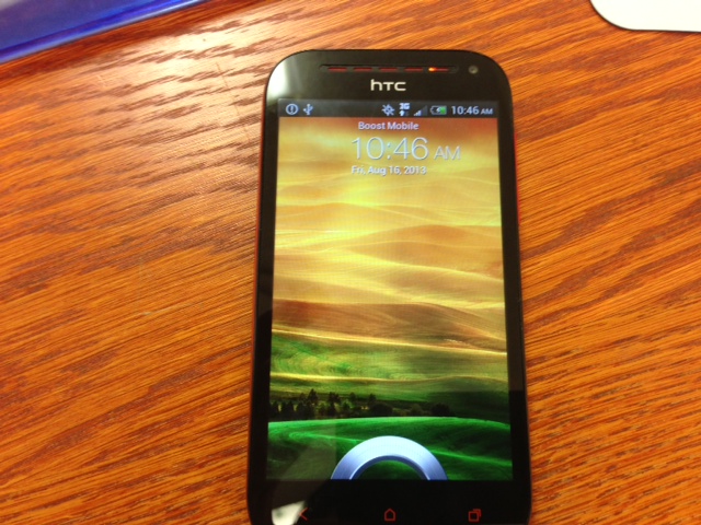

Hey guys I end up bricking my phone after failed trying to install moonshine. Every time i started up my phone. i just see the HTC and then a blank screen after that. I got my bootloader unlocked and i can go to CWM by using the cmd command. Just wondering if anybody have stock recovery for CWM so i can get my phone working again. THANKS!
you need to flash the stock boot.img
moonshine flashes an unsecured boot.img during the process
