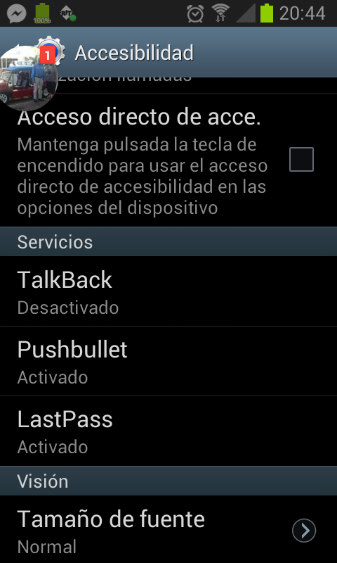

Thanks for the suggestion. I've looked at it, and none of my apps look like the cuplrit. I attach a screenshot showing my services. (note that I deliberately have language set to Spanish).
