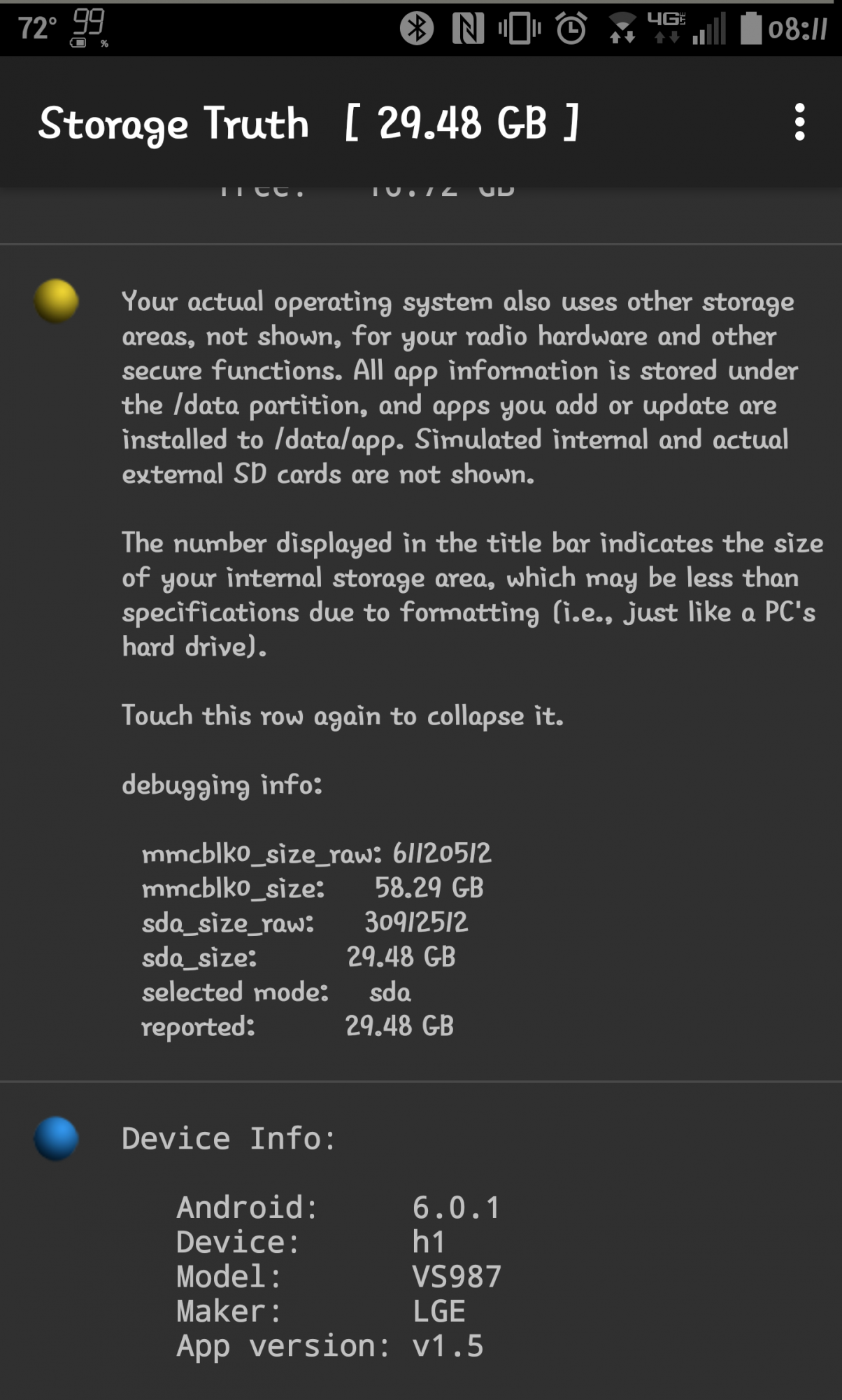

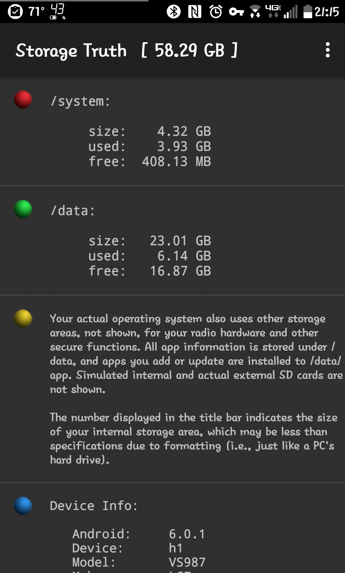

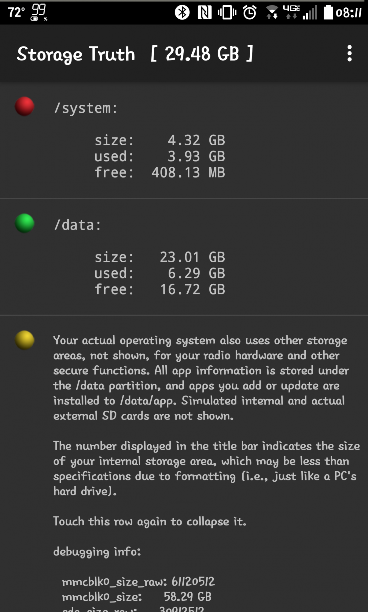

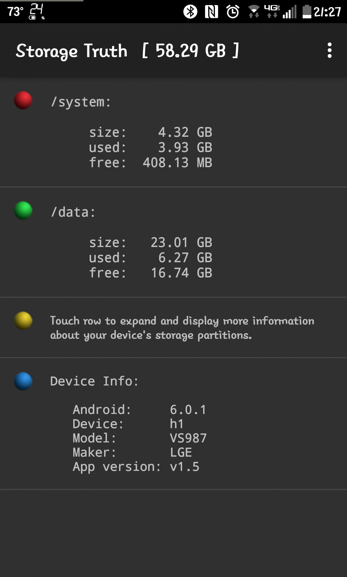

In checking with this fantastic app, Storage Truth , I noticed that it reads my external sd card memory.
I thought the app only displayed the internal storage available.
As seen in the title bar, I was curious as to why it displays 58.29 GB when my device is only 32GB.
My external SD card is 64GB, and I understand the 58.29 being shown (as some memory is taken up by other stuff).
So according to the notes written in the screenshot "the number displayed in the title bar indicates the size of the internal storage area......"
Confused, so I hit up Scary and ran an adb command, "adb shell cat /proc/partitions"
and here are the results.
I'll let @scary alien fill in some of the info :)

Thanks, @Mikestony!
That's exactly what I needed to see...
The "179 0 61120512 mmcblk0" row (fourth row from the bottom) is what the app looks for to figure-out and later show (in the title bar) the size of the internal memory....
I'm pretty sure we (me and @EarlyMon) selected this file and info as the source for the total size of internal memory and that it would/should exclude the internal.
Do you actually have a removable, external SD card for your device? (or is the "SD card" area partitioned from a portion of /data?)
Yup, I do. I also did not make the SD card as "adoptable storage" as some folks have done (even though it is possible on my device).

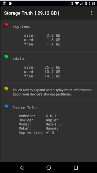

Hey Mike, it looks like the good folks at stackoverflow.com have come through again :).
In this page:
they reference the logic used in the Settings app (presumably in the Settings -> Storage & USB -> Internal storage screen):
I've tested this on my Nexus 6P and I get a value of 28.13 GB vs. the 29.12 GB that /proc/partitions reports for "mmcblk0".
I'm pretty confident that this new way is a better and more accurate way of doing things, but I'd like to research it a bit more.
Ping me back if you'd like me to send you an .apk of the test app (I think I can actually have you be a beta tester and download it directly from the Play Store--I've never done that before ;) :)...lemme know :)).

The phone in question almost certainly is using this Samsung UFS storage chip -
http://www.samsung.com/semiconductor/products/flash-storage/ufs/KLUBG4G1CE-B0B1?ia=2413
Linux users will immediately recognize the sdX references in the /proc/partitions output - UFS uses the SATA Linux interface instead of the one for eMMC.
The solution I'd go with would be to scan for sda, if found use its value, and if not, use the original Storage Truth methods. :)

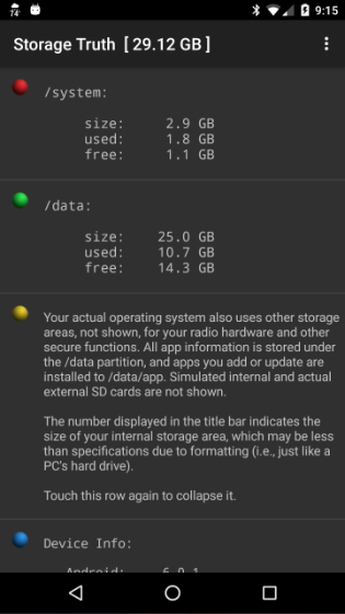

Okay, some screenies and explanation of what this new version does:
1. This version will now scan for "sda" in /proc/partitions just like it does for "mmcblk0"; if "sda" information is found, that will be used for the info in the title bar
@EarlyMon: was thinking / noodling with the idea of rounding that value up to the next likely size boundary (similar to what we do for RAM Truth)...thoughts re. that or let sleeping doges lie?

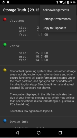

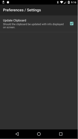

2. This version now supports turning off the copying to the clipboard in a new settings/preferences menu option; you can explicitly copy screen contents to the clipboard from the settings/preference menu or by touching the last (device info) row (assuming you haven't turned off copying to clipboard in preferences)
3. For the third row (yellow sphere icon), I'm now initially displaying "Touch row to expand and display more information about your device's storage partitions.". Then, when you touch the row it will display the info that it typically would ("Your actual operating system also uses other storage areas, not shown, for your radio hardware and other secure functions. All app information is stored under the /data partition, and apps you add or update are installed to /data/app. Simulated internal and actual external SD cards are not shown.", etc.).
This should make the display a little more compact and eye-friendly, especially for smaller screen devices.
I'm happy to further change/tweak/revert as needed :).
Lemme know if questions or comments.
Current v1.5 .apk is attached (not yet on the Play Store) for those that want to try/test (@Mikestony, @EarlyMon :)).
Thanks! :)
edit: test .apk removed from this post...newer version will appear in post later in this thread (unless it's been vetted an published to the Play Store)
Thanks, @AZgl1500 :).
Okay, @Mikestony, I think/believe I know what the issue was...involved the parsing of the /proc/partitions file and some minor changes I made to that area of code.
So, let's try this .apk (attached below) and see...please also post a screenie with the third row (yellow sphere) expanded--I threw some debugging info in there just in case.
Thanks again! :)
Whew! That's awesome, Mike :).
Okay, I'll do some cleanup and prep this version for publishing to the Play Store!
Thanks for reporting your initial issue--very much appreciate you helping to debug and test.
I found and fixed several minor things in the app that benefited from this process that made the app better and more robust for all (and, of course, @EarlyMon's sage and key knowledge about the sda /UFS information).
Teamwork for the win! :)
Play Store updated :), although it might take an hour or two for it to be available (update: it's already live!)
