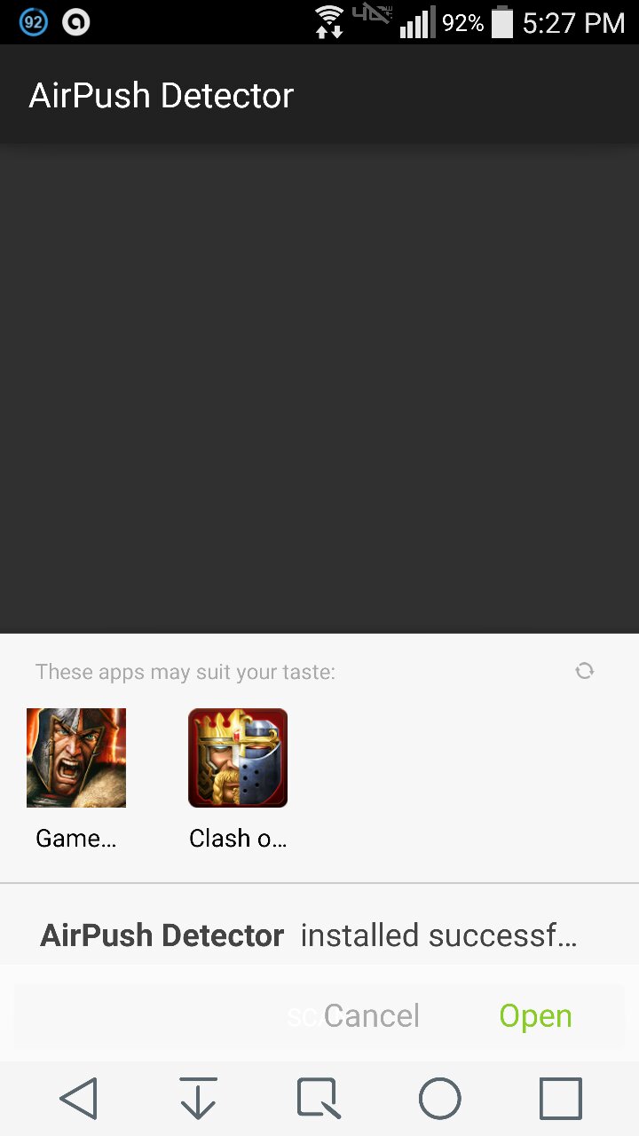

I have the LgG3, and every time I go to the Play Store and download an app, I get a pop up that covers half the screen and pops up and down saying "These apps may suit your taste." I don't know where it came from or how to disable it. I've attached a screenshot and would sure appreciate some answers:

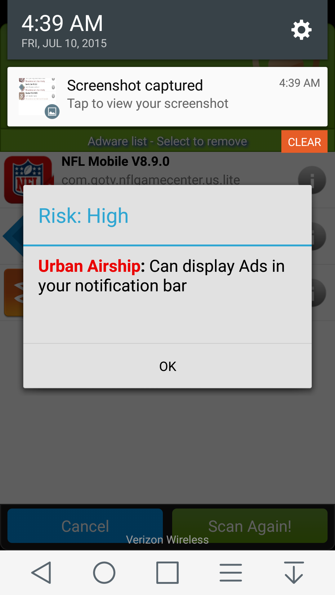

yes, i redid my phone 4 times and then i got this app called "adware". i ran it & it shows what the problem is. i have included 2 snapshots showing what it is on my phone. the apps you see in the snapshot are okay because on the "nfl & slacker", those are bloatware that came on the phone so i have disabled those on my phone & for "sams club", i use that alot but it is not just 1 app on your phone that does it but many apps. also, after buying an app for adfree, you have a 15 min time frame to get your money back. during the 15 minute, run the "adware" app" & it will show you that an ad or ads are still connected. if i still see it, i get my refund back within the 15 min time frame. the "adware" app you want to get looks like a red circle with a slash thru it. i got the pd version. hope this helps

What I'm concerned about is this pop-up that comes whenever I download an app ... and if I touch the actual app, it goes away, then it pops up again. Very tricky, because where it says what was installed correctly, 'cancel' and 'open' ... if you try to open the app and time it wrong, you've clicked on the pop up. No one else is getting this???
