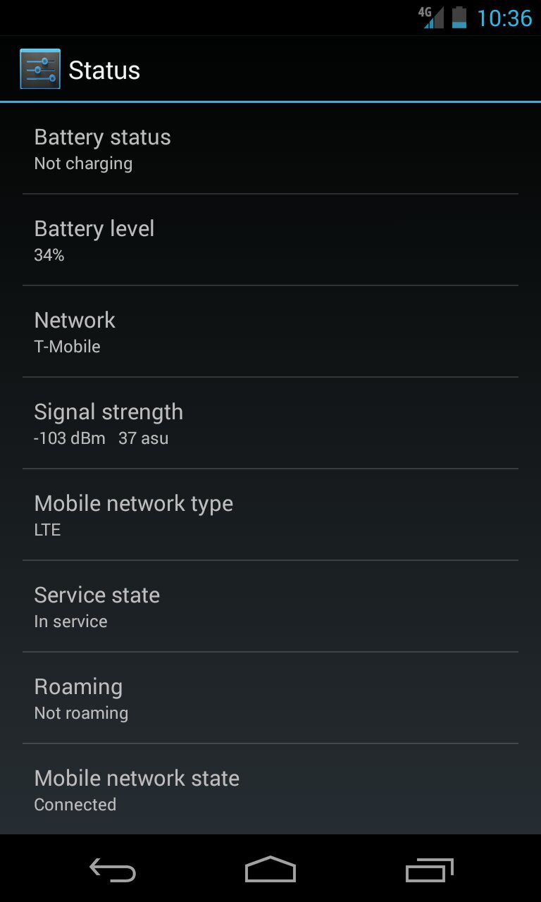

I understand this. So now there is twice the traffic on two bands? Also moving to LTE depends on whether its covered in one's area. I enabled LTE on my Nexus 4 and left it on LTE only and no go.

I understand and sorry that is just something I wanted to point out
I got LTE working now BTW :)
