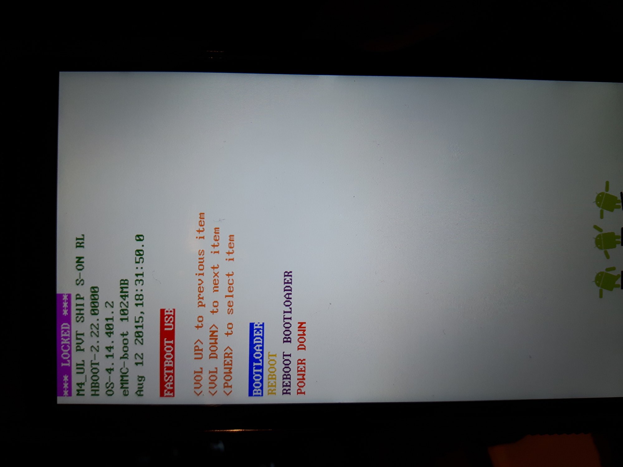

Same problem here. I think this happened to me because of installing the SoundAbout app from Google Play (https://play.google.com/store/apps/details?id=com.woodslink.android.wiredheadphoneroutingfix). A few days after the installation, I reboot my HTC One mini and that's it.. got stuck in the bootloader..
I took it to the service and they said it was necessary to replace the entire motherboard. I did everything you wrote here and nothing worked, so I'm wondering if there is anything else I can do.
Thank you in advance,
Lovro
If the repair place has given an honest and accurate assessment of the problem then it's just a coincidence that it happened a couple of days after you installed that app.
If you are stuck in the bootloader and can't even access recovery (remember that you need to do some extra button presses once in recovery to get the menu, otherwise it just looks like a black screen with a red triangle or something like that), then there's nothing else you can do apart from find a compatible RUU and try to reflash the device. And if you cannot find a compatible one, or you can but that doesn't fix it, there is nothing else you can do.
The SoundAbout application does something with a headphone jack. I installed it because the headphone jack did not work properly, and after installation it worked perfectly. I think it's the app because it's the only application on the phone that does something with hardware, so i think the application has messed up the hardware and bircked the phone. I just know that in the repair place they said they need to replace the motherboard and nothing else. I think i found stock rom here: http://www.htc.com/us/support/rom-downloads.html (model is HTC One mini), but i do not think that is what i need. I uploaded the image of phone screen.
HTC US RUUs will be US carrier software. If yours is a US carrier phone and there is one for your carrier there then there's a chance. Otherwise we need your cidnum (which you can get using fastboot - haven't time to explain now), or the country and carrier (if any) it was originally sold through, to work out what RUU would be compatible.
An app is still just software, and to damage the motherboard would be tricky even if you set out to do it deliberately - I think you'd need kernel mods at the minimum. That app is just choosing which of the existing audio interfaces to use, and doesn't even need root access, so I don't see any way it could damage the hardware or system software (and hardware damage we won't be able to fix by flashing).
