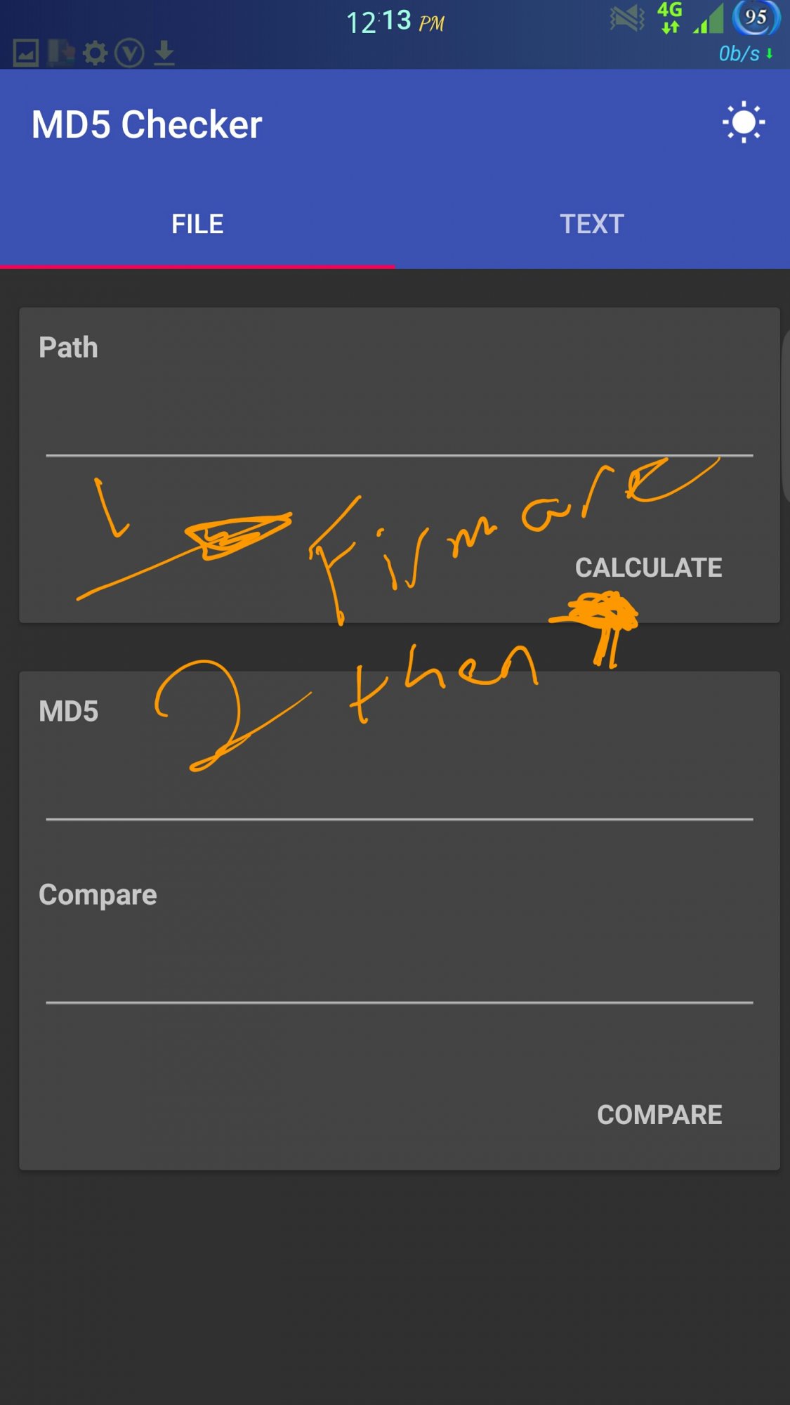

Use an Md5 check to varify the downloaded firmware. It should be provided from the site you got it from. Look for md5 or hash tag. 32 digit code of numbers and letter. I run an app on android called md5 Im pretty sure you can find a program to do te same on pc. If this results do not match. You download is corrupted.

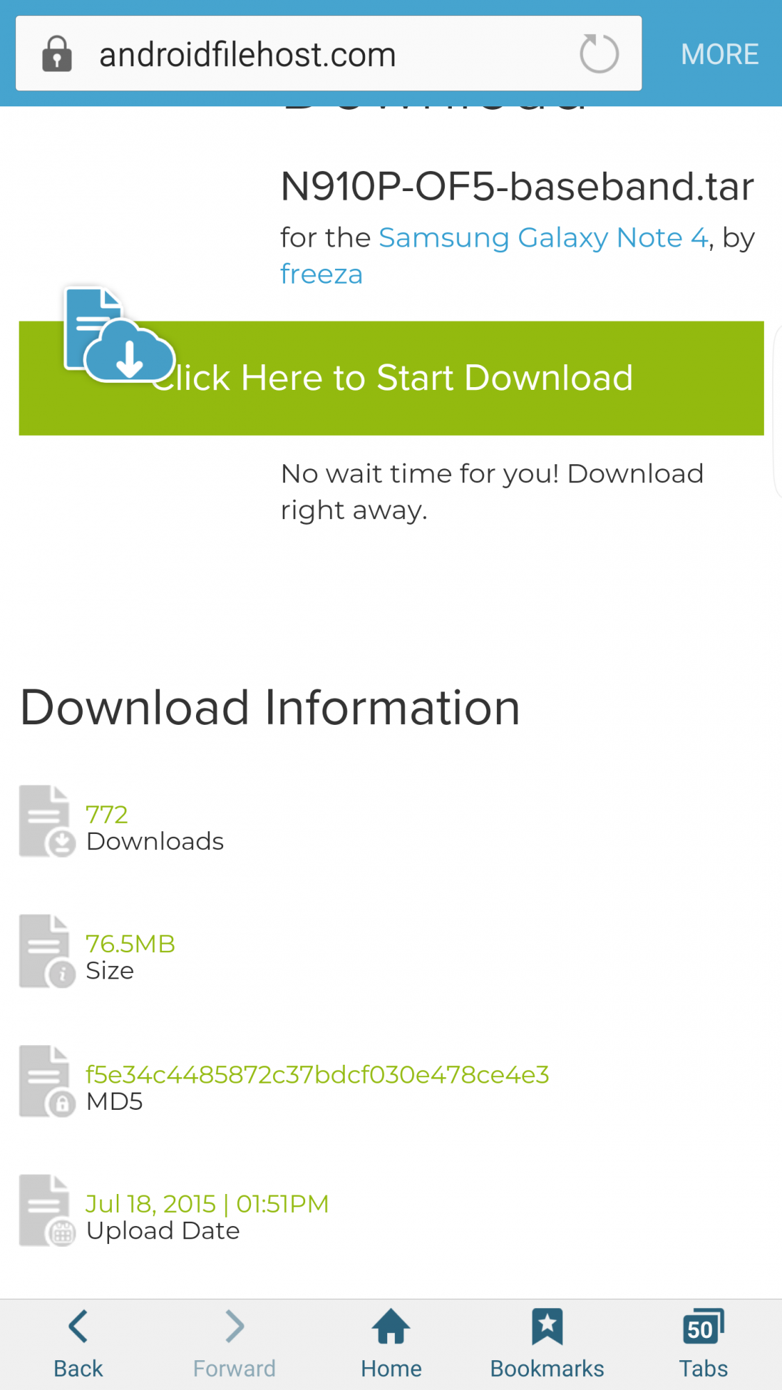

The site page from that you downloaded the firmwares don't offer Md5? WoW
This is an example of a baseband for y device that provides a md5
Firmware for your device SamMobile however free downloads a slow, slow, slow but if are able to fine the same firmware that you have already downloaded simply vopy the md5 and compare that with md5 checker. If they match them you have confemation of a valid dwnload.
