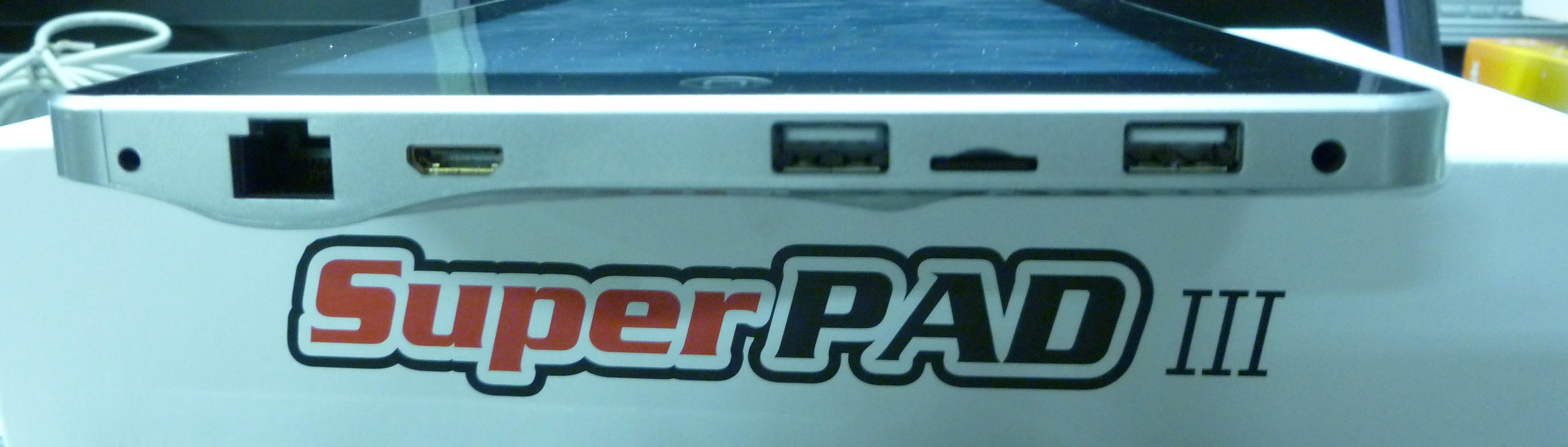

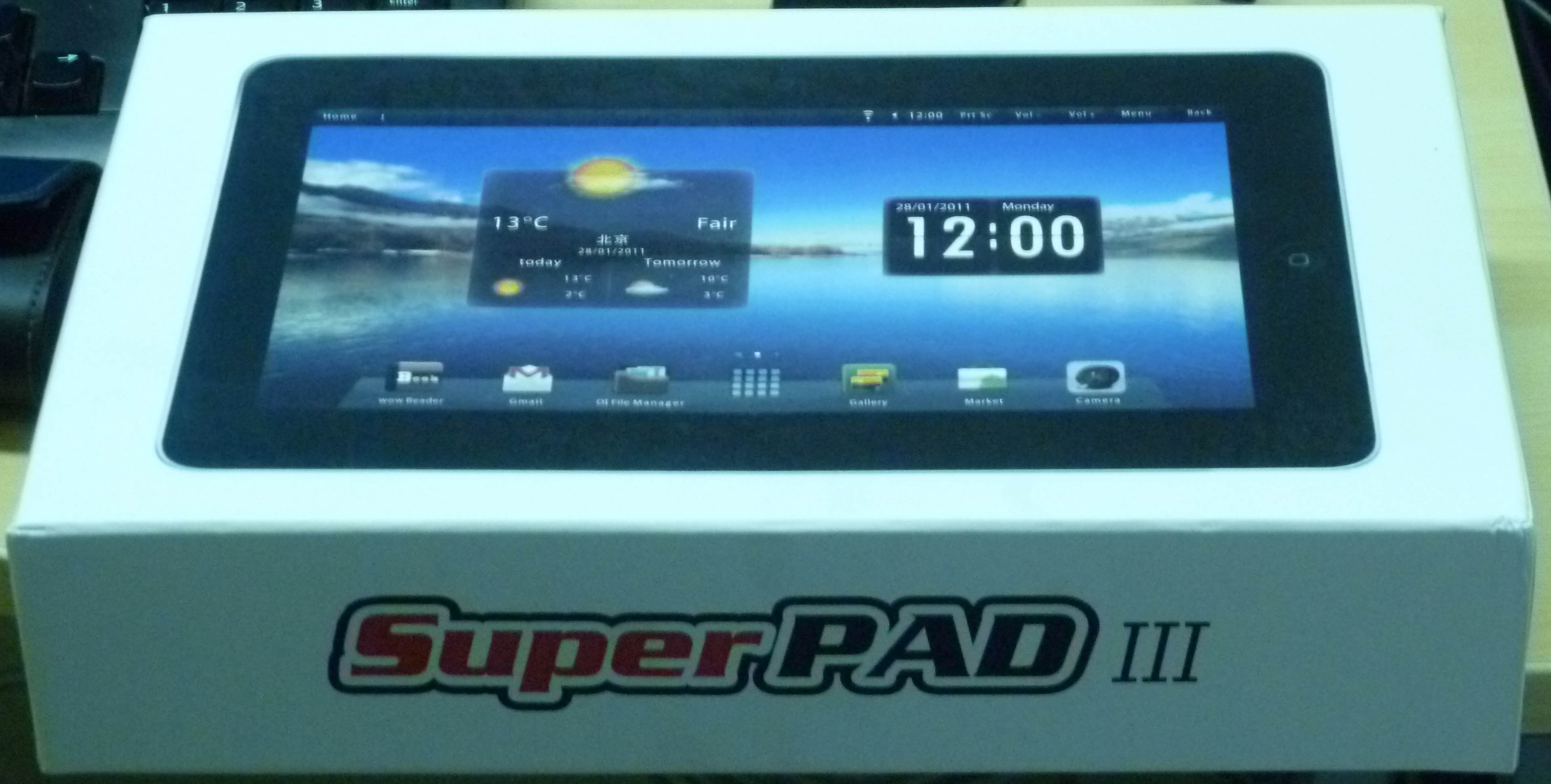

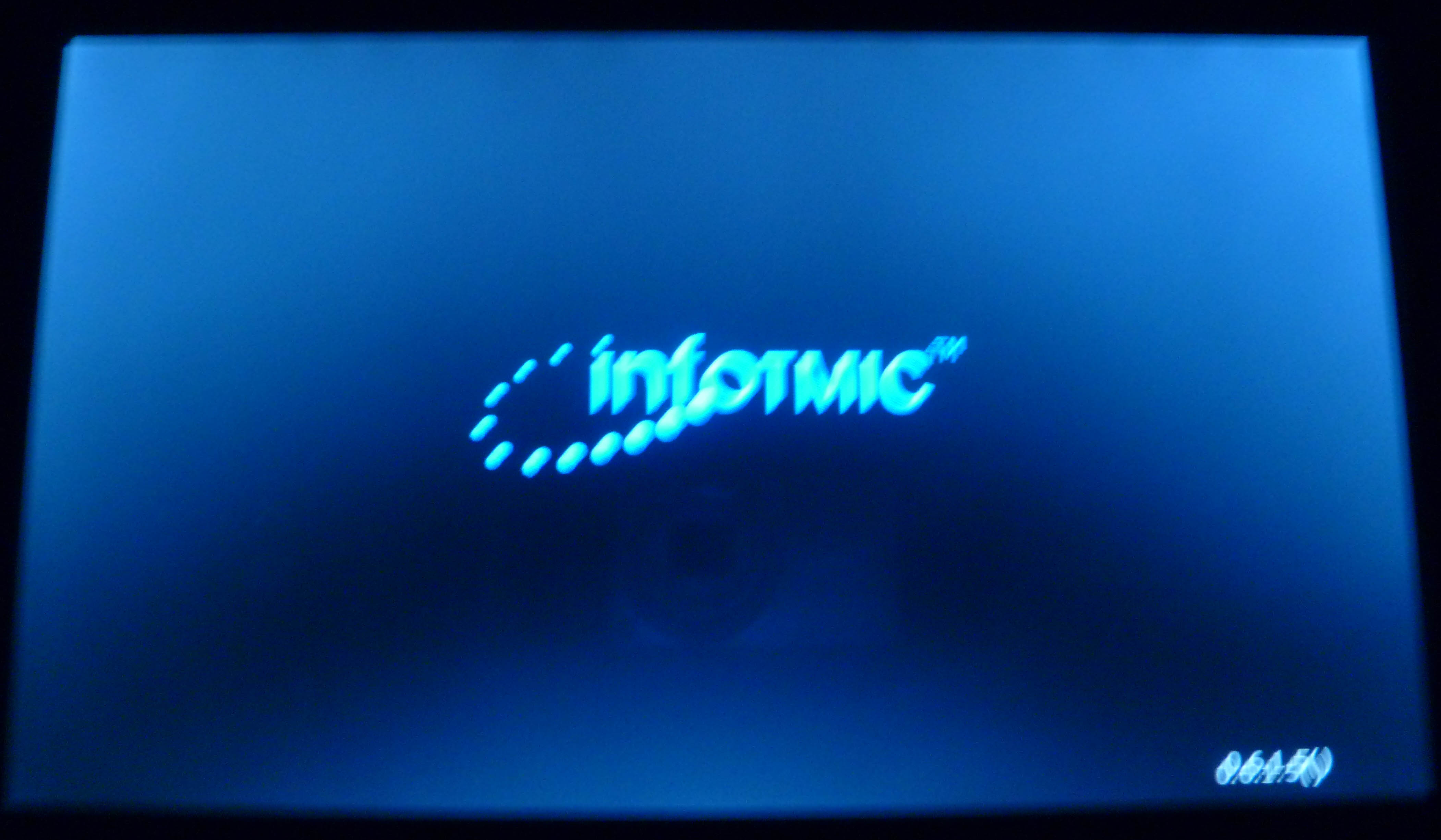

Hello everybody,
I have two flytouch : one II and one III.
The first one have no problem to accept an upgraded firmware.
For the second i try :
"How to upgrade the firmware...?
1-Format a micro sd card
2-Copy the firmware files onto the memory card
3-Put the memory card into the device
4-Press the power button, and the device will automatically upgrade itself"
I say NO, don't work, never.
For the superpad II, i have to press power + home to launch the upgrade.
So, power+home don't work either on the superpad III...
Is this possible to upgrade with usb ? burntool or something ?
If you want any other information, just answer
Thx for the help !
PS : 3 pics of my superpad III in attachement.
PS2: characteristic of my superpad III => Modelnumber : SAWEE10 - android version 2.2 V2.1:#3925 - Build FRF85B

"Currently the device hangs at the INFOTMIC screen, and does not continue. Pressing bak+home+power brings me to the restore menu, but then it hangs at 1 second. Pressing within the 5 seonds back+home, it give a message that no recovery is found, try from SD." quoted from xda forum

Currently my superpad III stops at ANDROID _, and I still find the correct *.img or a single *.ius file to burn.
