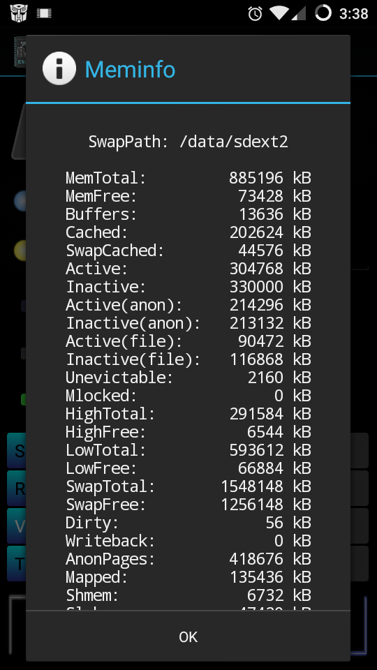

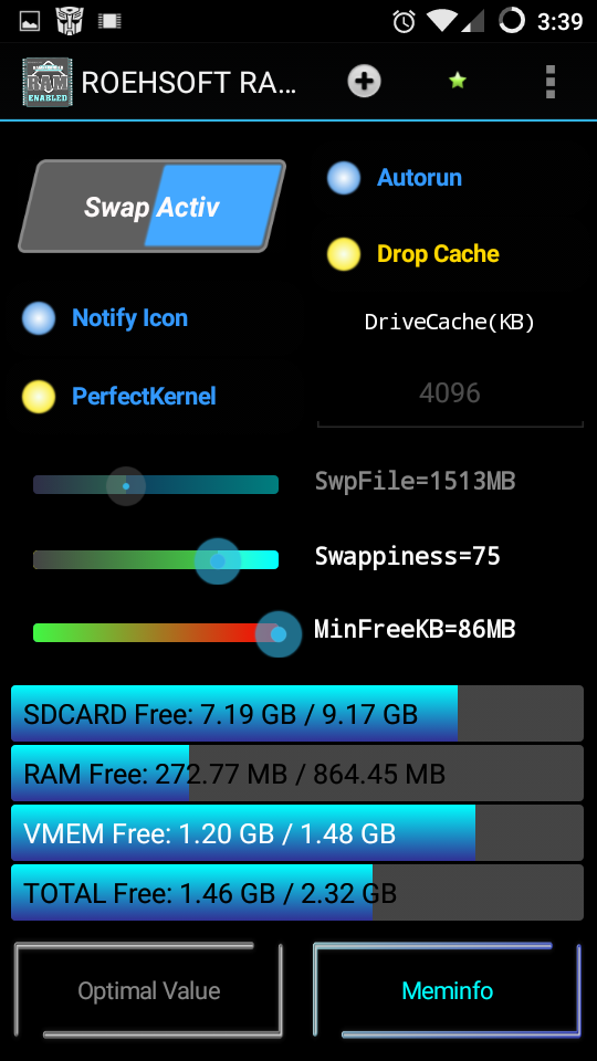

Hey all..I've finally made an account so I can help the community out. As far as our volts, swap depends on kernal. I got Cm12 on mine courtesy of Bad_moFo_33. I used ram expander for swap. No init.d editing needed. I also got link2sd, and created a second partition on my SD card, ext4 formatted of course. From there had link2sd mount the partition and then had ramexpander create a swap file using the mount point for the second partition /data/sdext2. AND BOOM! my swapfile is located on the ext4 formatted partition along with everything that I send with link2sd. Using a class 10, 32 gb SD card, I got it split that 20 GB, fat 32 formatted is for my external SD card needs and the other roughly 12 gb is the ext4 formatted used for swap and app, data, cache storage. I still got that tiny space on my internal Sd without the limitations of app install due to space....

And in theory you don't need ramexpander. You can create a init.d script that turns on swap, with it linking it to the link2sd partition mount /data/sdext2. There's many ways around a mountain, you just got to choose one. Also everything is running smooth for me, using a 1.5 gb swapfile, which is overkill but has every game I got on my volt runner smooth as butter, with no slowdowns or stutters. Its up to you by testing swapfile sizes to see what works for you best
