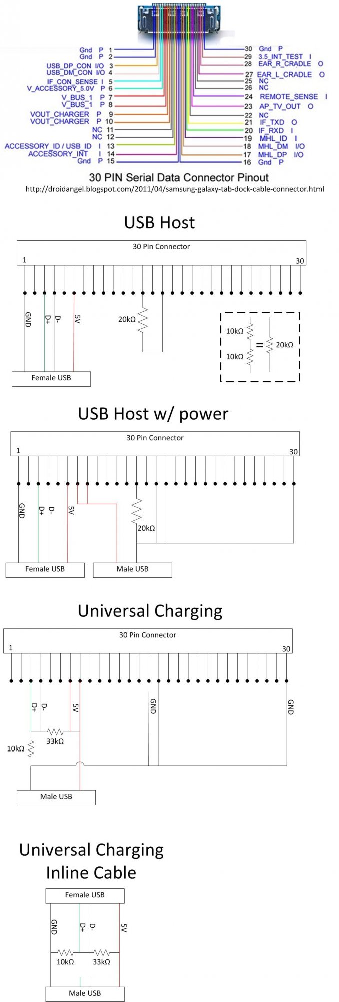

I resurrected my Tab 2 10.1 after my son left it in a corner for several months. I left it on the charger for a day and a half before it would start.
Here is a pinout of the 30-pin connector.
Hi. Yeah done that with the long charge.
Dang! What I want is the battery pinouts, so I can charge it up and see if the tab is OK.
