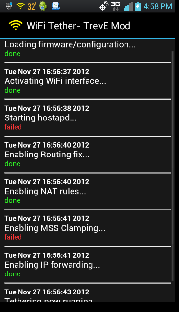

Can someone go over to
Downloads - android-wifi-tether - Wireless Tether for Root Users - Google Project Hosting
Download the latest experimental build wifi_tether_v3_3-pre2.apk
Give it a try using the generic ICS wlan0 setup. Make sure to select hostapd for the setup method.
Pull a logcat for me if you can so I can see what is happenning.
When I was working on this, I had to replace wpa_supplicant with the old GB binary to get around the wifi tether issues in that screen shot. I could never get it to broadcast an SSID to connect to thou. I was on 3.2-b2 at the time.

Still the same base error I was getting:
E/msm8660.hwcomposer( 212): isBypassDoable: Unable to enable bypass due both down-scaling and blending
I've been digging thru the framework jars and there is a whole section that belongs to tethering. I'm having issues getting it to anything other then .smali , so reading thru it is a pain and I'm not even sure if that is what is causing the issue.
This above log comes from 3.3-b2.
After pasting what files I could find to the data/misc/wifi folder, i got this.
Working for me too! I am posting this from my laptop wirelessly tethered thru my phone... thank you ladamich!

I/Adreno200-EGLSUB(  212): <GetImageAttributes:1102>: RGBA_8888
D/TETHER -> TetherApplication( 3124): Copying file '/data/data/com.googlecode.android.wifi.tether/bin/iwconfig' ...
D/TETHER -> TetherApplication( 3124): Copying file '/data/data/com.googlecode.android.wifi.tether/bin/ifconfig' ...
D/TETHER -> TetherApplication( 3124): Copying file '/data/data/com.googlecode.android.wifi.tether/conf/tether.edify' ...
D/TETHER -> Configuration( 3124): Device [ Model / SDK ] *User_Selected*: generic_ics / 15
D/TETHER -> CoreTask( 3124): Writing 835 bytes to file: /data/data/com.googlecode.android.wifi.tether/conf/tether.conf
D/TETHER -> TetherApplication( 3124): Copying file '/data/data/com.googlecode.android.wifi.tether/conf/hostapd.conf' ...
I/Adreno200-EGLSUB(  212): <CreateImage:893>: Android Image
D/TETHER -> CoreTask( 3124): Writing 115 bytes to file: /data/data/com.googlecode.android.wifi.tether/conf/hostapd.conf
D/TETHER -> TetherApplication( 3124): Creation of configuration-files took ==> 24 milliseconds.
D/TETHER -> TetherService( 3124): Driver Setup Method Check for driver reload
D/TETHER -> CoreTask( 3124): Root-Command ==> su -c "/data/data/com.googlecode.android.wifi.tether/bin/tether start"
E/su      ( 3821): sudb - Opening database
E/su      ( 3821): sudb - Database opened
E/su      ( 3821): sudb - Database closed
D/su      ( 3821): 10131 /system/bin/mksh executing 0 /data/data/com.googlecode.android.wifi.tether/bin/tether start using shell /system/bin/sh : sh
E/ThermalDaemon(  221): Sensor 'tsens_tz_sensor0' - alarm raised 3 at 50.0 degC
D/ConnectivityService(  442): handleInetConditionHoldEnd: net=0, condition=0, published condition=0
D/ConnectivityService(  442): sendStickyBroadcast: action=android.net.conn.INET_CONDITION_ACTION
D/StatusBar.NetworkController(  625): TYPE_MOBILE is Connected = true
E/ThermalDaemon(  221): Sensor 'tsens_tz_sensor0' - alarm cleared 3 at 48.0 degC
D/hostapd ( 3409): RTM_NEWLINK: operstate=1 ifi_flags=0x11043 ([UP][RUNNING][LOWER_UP])
D/hostapd ( 3409): nl80211: Interface up
D/hostapd ( 3409): Unknown event 29
D/hostapd ( 3409): RTM_NEWLINK, IFLA_IFNAME: Interface 'wlan0' added
D/hostapd ( 3409): Unknown event 5
D/Tethering(  442): interfaceLinkStateChanged wlan0, true
D/Tethering(  442): interfaceStatusChanged wlan0, true
D/NetdConnector(  442): RCV <- {600 Iface linkstate wlan0 up}
D/Tethering(  442): sendTetherStateChangedBroadcast 2, 0, 0
D/Tethering(  442): portforwardingstatus = 0 : sendTetherStateChangedBroadcast
D/MobileDataStateTracker(  442): default: setPolicyDataEnable(enabled=true)
D/hostapd ( 3835): random: Trying to read entropy from /dev/random
E/hostapd ( 3835): Configuration file: /data/data/com.googlecode.android.wifi.tether/conf/hostapd.conf
E/hostapd ( 3835): Line 2: unknown configuration item 'channel_num'
D/hostapd ( 3835): nl80211: interface wlan0 in phy phy0
I/hostapd ( 3835): rfkill: Cannot open RFKILL control device
D/hostapd ( 3835): nl80211: RFKILL status not available
D/hostapd ( 3835): nl80211: Using driver-based off-channel TX
D/hostapd ( 3835): nl80211: Register frame command failed (type=208): ret=-114 (Operation already in progress)
D/hostapd ( 3835): nl80211: Failed to register Action frame processing - ignore for now
D/hostapd ( 3835): nl80211: Add own interface ifindex 22
D/hostapd ( 3409): RTM_NEWLINK: operstate=1 ifi_flags=0x1002 ()
D/hostapd ( 3409): nl80211: Interface down
D/hostapd ( 3409): Unknown event 30
D/Tethering(  442): interfaceLinkStateChanged wlan0, false
D/Tethering(  442): interfaceStatusChanged wlan0, false
D/Tethering(  442): InitialState.processMessage what=4
D/Tethering(  442): sendTetherStateChangedBroadcast 1, 0, 0
D/NetdConnector(  442): RCV <- {600 Iface linkstate wlan0 down}
D/Tethering(  442): interfaceAdded m.wlan0
D/Tethering(  442): m.wlan0 is not a tetherable iface, ignoring
D/hostapd ( 3409): nl80211: Ignore event for foreign ifindex 24
D/NetdConnector(  442): RCV <- {600 Iface added m.wlan0}
D/hostapd ( 3835): nl80211: New interface m.wlan0 created: ifindex=24
D/hostapd ( 3835): nl80211: Add own interface ifindex 24
D/Tethering(  442): interfaceLinkStateChanged m.wlan0, false
D/Tethering(  442): interfaceStatusChanged m.wlan0, false
D/Tethering(  442): interfaceLinkStateChanged m.wlan0, true
D/Tethering(  442): interfaceStatusChanged m.wlan0, true
D/NetdConnector(  442): RCV <- {600 Iface linkstate m.wlan0 down}
D/NetdConnector(  442): RCV <- {600 Iface linkstate m.wlan0 up}
D/hostapd ( 3835): BSS count 1, BSSID mask 00:00:00:00:00:00 (0 bits)
D/hostapd ( 3835): nl80211: Regulatory information - country=00
D/hostapd ( 3835): nl80211: 2402-2472 @ 40 MHz
D/hostapd ( 3835): nl80211: 2457-2482 @ 20 MHz
D/hostapd ( 3835): nl80211: 2474-2494 @ 20 MHz
D/hostapd ( 3835): nl80211: 5170-5250 @ 40 MHz
D/hostapd ( 3835): nl80211: 5735-5835 @ 40 MHz
D/hostapd ( 3835): nl80211: Added 802.11b mode based on 802.11g information
E/hostapd ( 3835): ACS: automatic channel selection started...
E/hostapd ( 3835): ACS was disabled on your build, rebuild hostapd with CONFIG_ACS=1
D/hostapd ( 3835): Completing interface initialization
D/hostapd ( 3835): RATE[0] rate=10 flags=0x1
D/hostapd ( 3835): RATE[1] rate=20 flags=0x1
D/hostapd ( 3835): RATE[2] rate=55 flags=0x0
D/hostapd ( 3835): RATE[3] rate=110 flags=0x0
D/hostapd ( 3835): Flushing old station entries
W/hostapd ( 3835): Could not connect to kernel driver.
D/hostapd ( 3835): Deauthenticate all stations
D/hostapd ( 3835): wpa_driver_nl80211_send_mlme: Sending frame on ap_oper_freq 0 using nl80211_send_frame_cmd
D/hostapd ( 3835): nl80211: Frame command failed: ret=-22 (Invalid argument) (freq=0 wait=0)
D/hostapd ( 3835): wpa_driver_nl80211_set_key: ifindex=22 alg=0 addr=0x0 key_idx=0 set_tx=0 seq_len=0 key_len=0
D/hostapd ( 3835): wpa_driver_nl80211_set_key: ifindex=22 alg=0 addr=0x0 key_idx=1 set_tx=0 seq_len=0 key_len=0
D/hostapd ( 3835): wpa_driver_nl80211_set_key: ifindex=22 alg=0 addr=0x0 key_idx=2 set_tx=0 seq_len=0 key_len=0
D/hostapd ( 3835): wpa_driver_nl80211_set_key: ifindex=22 alg=0 addr=0x0 key_idx=3 set_tx=0 seq_len=0 key_len=0
E/hostapd ( 3835): Using interface wlan0 with hwaddr f0:1c:13:47:5f:7b and ssid 'AndroidTether'
D/hostapd ( 3835): wpa_driver_set_ap_wps_p2p_ie: Entry
D/hostapd ( 3835): nl80211: Set beacon (beacon_set=0)
D/hostapd ( 3835): nl80211: Set beacon (ignore_broadcast_ssid=0)
D/hostapd ( 3835): nl80211: Register frame command failed (type=64): ret=-114 (Operation already in progress)
D/hostapd ( 3835): wpa_driver_nl80211_set_operstate: operstate 0->1 (UP)
D/hostapd ( 3835): netlink: Operstate: linkmode=-1, operstate=6
D/hostapd ( 3835): Failed to set TX queue parameters for queue 0.
D/hostapd ( 3835): Failed to set TX queue parameters for queue 1.
D/hostapd ( 3835): Failed to set TX queue parameters for queue 2.
D/hostapd ( 3835): Failed to set TX queue parameters for queue 3.
D/hostapd ( 3835): wlan0: Setup of interface done.
D/hostapd ( 3836): random: Got 20/20 bytes from /dev/random
D/hostapd ( 3836): RTM_NEWLINK: operstate=1 ifi_flags=0x1002 ()
D/hostapd ( 3836): nl80211: Interface down
D/hostapd ( 3836): Unknown event 30
D/hostapd ( 3836): RTM_NEWLINK, IFLA_IFNAME: Interface 'wlan0' added
D/hostapd ( 3836): Unknown event 5
D/hostapd ( 3836): RTM_NEWLINK, IFLA_IFNAME: Interface 'm.wlan0' added
D/hostapd ( 3836): RTM_NEWLINK: operstate=1 ifi_flags=0x11043 ([UP][RUNNING][LOWER_UP])
D/hostapd ( 3836): nl80211: Interface up
D/hostapd ( 3836): Unknown event 29
W/InputManagerService(  442): Window already focused, ignoring focus gain of: com.android.internal.view.IInputMethodClient$Stub$Proxy@427bda70
D/ServiceStartupReceiver( 3124): onReceive com.googlecode.android.wifi.tether.intent.MANAGE
D/TETHER -> CoreTask( 3124): Root-Command ==> su -c "/data/data/com.googlecode.android.wifi.tether/bin/tether stop"
E/su      ( 3915): sudb - Opening database
E/su      ( 3915): sudb - Database opened
E/su      ( 3915): sudb - Database closed
D/su      ( 3915): 10131 /system/bin/mksh executing 0 /data/data/com.googlecode.android.wifi.tether/bin/tether stop using shell /system/bin/sh : sh
D/hostapd ( 3836): RTM_DELLINK, IFLA_IFNAME: Interface 'm.wlan0' removed
D/hostapd ( 3409): RTM_DELLINK, IFLA_IFNAME: Interface 'm.wlan0' removed
W/Netd    (  209): No subsystem found in netlink event
D/NetlinkEvent(  209): Unexpected netlink message. type=0x11
D/NetdConnector(  442): RCV <- {600 Iface removed m.wlan0}
D/Tethering(  442): interfaceRemoved m.wlan0
E/Tethering(  442): attempting to remove unknown iface (m.wlan0), ignoring

You are going to need to reboot to get rid of those errors. Looks like hostapd can't pull enough data from /dev/random for entropy also.
Can you reboot then try this as a hack to see if it allows hostapd to work. You need to be root.
mv /dev/random /dev/random.old
ln -s /dev/urandom /dev/random
Then start the app up and see what happens.
If you are using hostapd then it shouldn't be using wpa_supplicant.
Strange. I think mss clamping was removed from the setup options. Can you uninstall everything and make sure there is nothing left over in /data/mis/wifi and start fresh?
thanks ladamich! wifi tether works! awesome work man. Wish you had more time so you could dev for us because you seem to know your stuff =D thanks again
