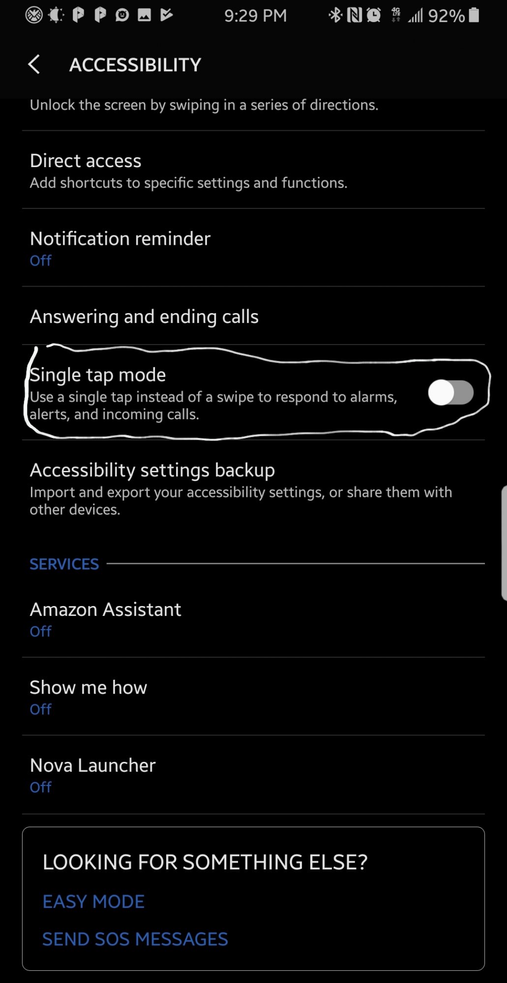

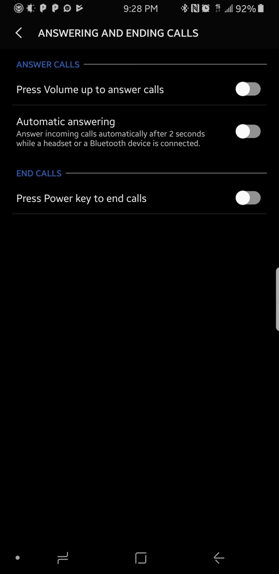

Also check the following screenshots and double-check the settings are the same.

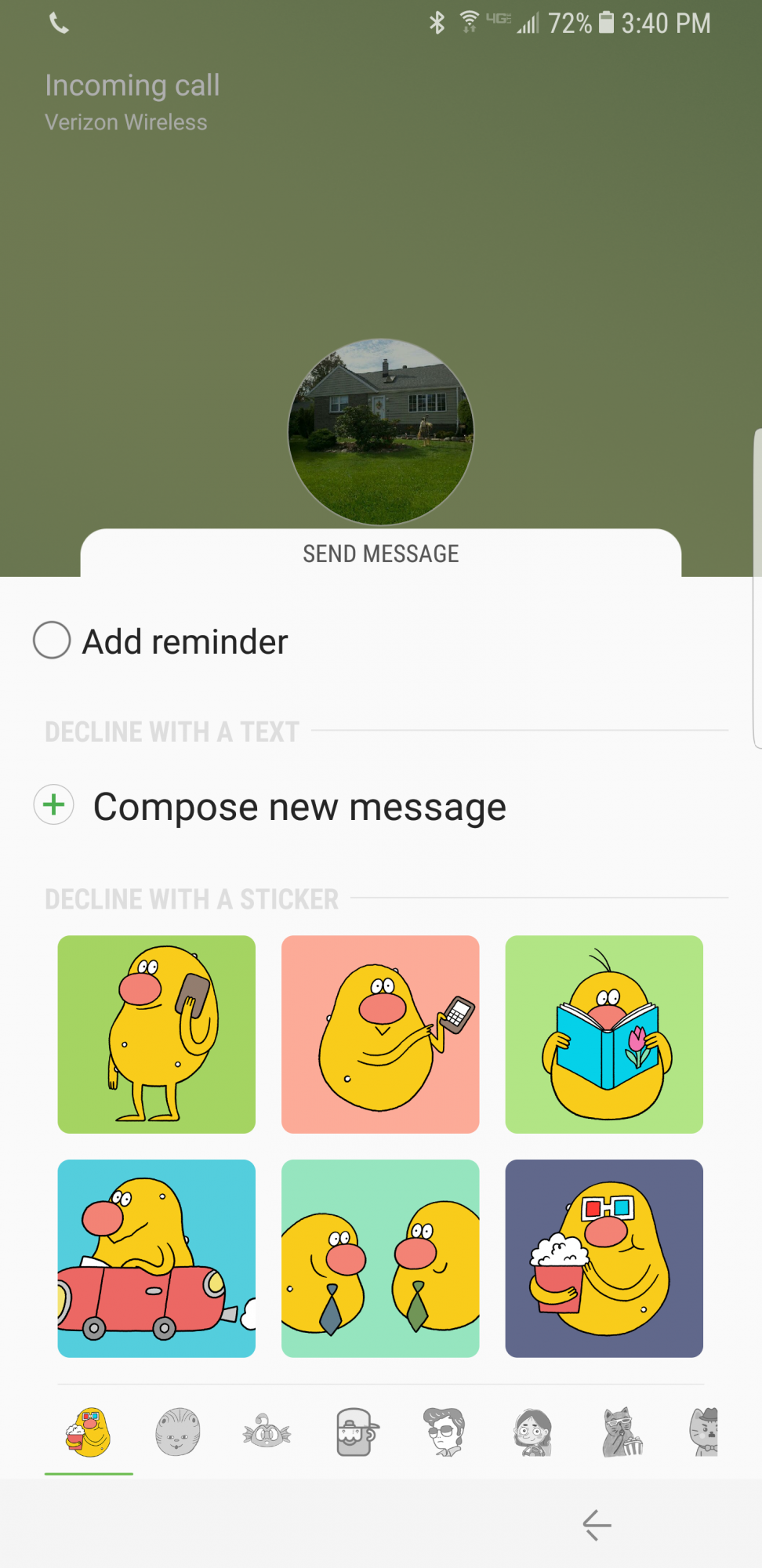

@A bochur, when I slide up with the messages option, this is what I get (see attached image). There are no messages set.

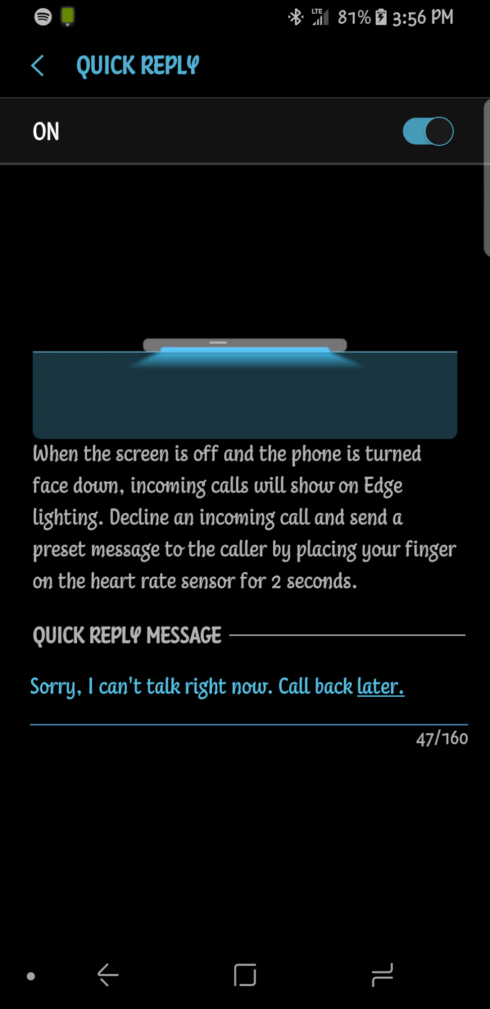

@MightyFurcules, so I saw this online about an edge lighting setting called quick reply. When it's turned on you get that text message. Mine was turned on I guess by default. This might be the problem.

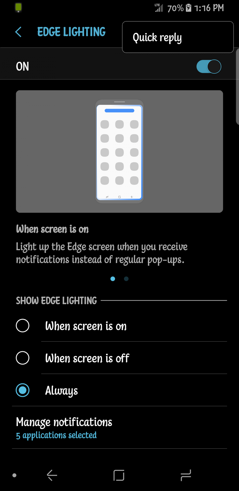

@MightyFurcules, When you click on Edge Lighting, there's 3 dots at the top press that quick reply. That's how you turn it off.

@Shotgun84 I have an S8+, on Edge screen there are options as to how you want to set lighting. If I tap on Edge Lighting that's where I get the screen which has the three dots.
I don't use always on display by the way, 'edge' is a separate option under display setting.
