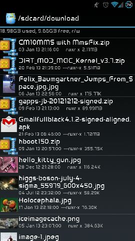

Wait, are you using the cm10 mms fix or the cm10.1 fix?
This is the file I've been flashing.
Where is the 10.1 fix ?
