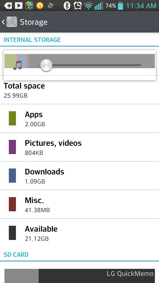

Check out this thread. If you have a memory card with a good read/write speed you can partition the card with a fat 32 partition and an ext4 partition and use this mod/hack to use the ext4 partition as internal storage. I have 25.99gb partitioned on a 64 gb card as my internal storage with no problems whatsoever. This is the only complete storage issue resolution that i know of. Anyone who has used it will definitely agree with me.
Here's a screen shot showing my storage.

At least class 10. I use a sandisk ultra u1 64gb card. I tried it on my girlfriends phone with a class six kingston and it didnt like it very much. It makes everything super slow

With the thread i linked it doesnt just move apps to the ext partition. It moves all of /data. How experienced are you? Is your phone rooted? Do you know how to flash zips?
There's a couple different ways to implement this trick on the thread. Other people find the flashing of the zips to be easiest but i went the file swap route. Its still a work in progress and not ready for the average user but i dont consider myself very experienced and i did it. They might be able to help you more on the other thread.
