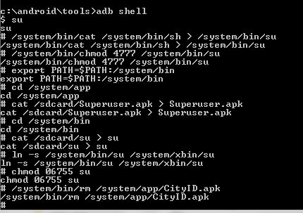

this is correct?
So I'm still getting nothing :( anyone have an idea?
I installed the SDK, HTC Sync, tried method one and two but nothing!
