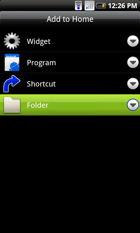

Thanks I know your busy, but when you have time can you take a look at this.
That and the other u asked about seem to be controlled by one of the SENSE UI apps. The screen you have there is not the ANDROID Add screen, I will be goin through the HTC files over the weekend, since i've recieved alot of feedback about MISSING things. Thanx for the feedback... Let me know of anything else you find!
