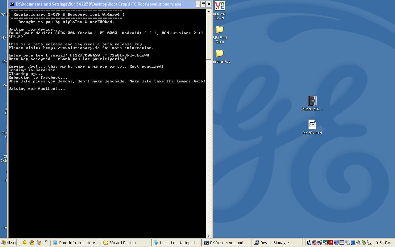

Alright so I figured out my problem & it was my driver. When my phone was in it only showed up as Android adb interface in the hardware manager. But now I am getting hung up on waiting for fastboot... I never had any problems before :(
tried updating the drivers with the phone in fastboot? sounds like you still have a driver issue :(
