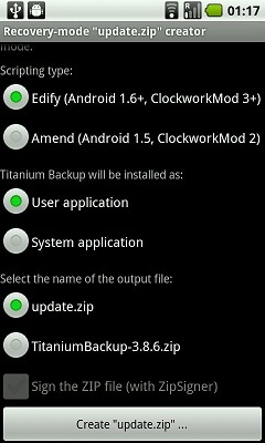

Has anyone tried the Update.zip creator in Titanium Backup? What are the implications of the update.zip file being "unsigned" if any? Also, what about System versus user installation?
Sorry for intruding here, from ZTE Blade forum, but I think there is an answer for the Update.zip you create, in order to have a copy of TB after re-flash, etc.
But, you need a signed version, which can be created by ZipSigner 2.
You can then use Recovery to install TB after Re-Flash, new ROM, etc.
See also here for discussion on TB use before and after complete wipe.
Hope this helps :)

What do you think of the update.zip point, regarding needing a signed version of the TB app, and using ZipSigner 2 for this??
The option is there, see screenshot....but is greyed out??? coz it is for ZipSigner original, which was problematical

Guess I've managed just fine without a signed version. I just install it from Market and then install missing apps and data from TIBU.
