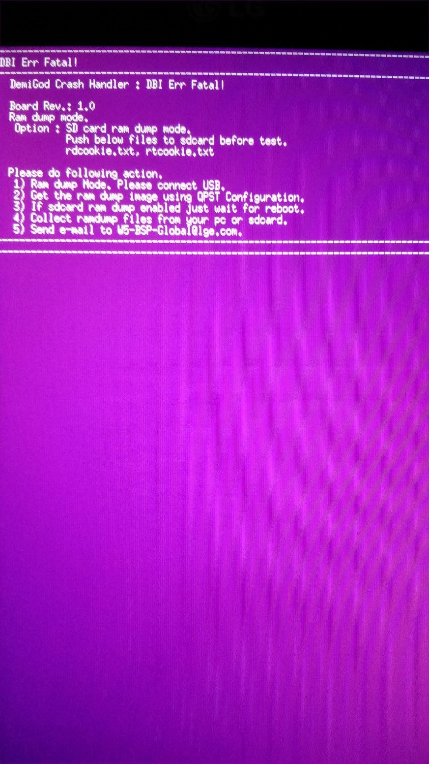

I have an LG L65 and getting the well-known error (picture). I've tried the LG Flash Tool, but I get the error message "unknown phone mode" after loading the .tot and the other file. I've tried factory reset - it didn't help anything. I've tried the LG Laf Recovery Multitool v. 1.2, but it can't detect my device though it's connected (I think because it's in this strange mode that couldn't be recognized by the other tools neither). But the phone doesn't boot, I can't get downloading mode - nothing. Could you help me? What to do that the softwares recognize this strange mode of the device?

Well, like it's been said a million times, don't do L70 stuff on the L65. People should have known this by now.

Yeah, I know, but I can't find any description on how to fix this error on L65. Does anyone have an idea?
You'll have to do it in linux,boot linux from usb stick and follow this tutorial
forum.xda-developers.com/showthread.php?t=2582142
I had same problem on my lg l70,just download correct file for you phone...

Day 4 of reading this thread and staring at the hideous purple screen on my phone (phone withdrawal symptons are increasing).
Switching on my phone gives me this screen, holding the power button (or power + lower volume) makes it restart and returns me to this screen. I remove the battery to switch my phone off.

Holy, you're going in so much different directions, can you access Download/Fastboot Mode (if you have unlocked bootloader) while phone turned off hold Power UP then connect USB to the computer (USB should already be plugged into PC all you need to do is connect)
Yes, at one point during this era of despair I managed to stumble into download mode.
I don't know about this unlocking bootloader. If I unlocked it, it was done by accident/unknowingly and I have no idea how to tell whether it is unlocked or not.
I just want to get my phone to the way it was when I got it out of the box (restoring stock firmware it's called, I believe?)
Also (just in case this is important) I removed my simcard which is now in my trusty nokia 6600
EDIT: While googling for the key combo to download mode (since I had stumbled on it by accident the last time) I found this and this. I installed the v3.11 driver, used the power&volume+ combo to get into download mode and installed the D320 (International L70) firmware (the link that is mentioned in those instructions was dead but I had gotten a kdz from somewhere else in the past week).
Currently charging my phone, logging into google account and restoring normality in my life.
Thanks for everything people :)
