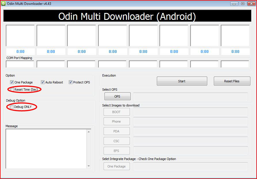

4- Start Odin Muti Downloader from the TransformUltraEasyRoot-Unroot (folder) make sure (Reset Time (sec)) and (Debug ONLY) are unchecked.
5- Click on the (OPS) button and assign the TransformUltra.ops from the TransformUltraEasyRoot-UnRoot (folder).

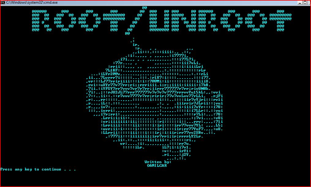

1- Make sure your phone is attached to your computer and USB debugging is checked on your phone. Now double click the Root--UnRoot (folder) then double click the Root--UnRoot.bat, press any key to continue...
2- Select option (1) to Root and install CWM (2)to UnRoot and go back to Stock recovery (3)Exit.

I downloaded TransformUltraEasyRoot-Unroot.
Opened Odin Multi DL v4.43 and I pull the COM address.
I selected C:\Users\owner\Desktop\TransformUltraEasyRoot-Unroot\TransformUltra.ops.
--Now here's the rub. My "One Package" button is grayed out (unclickable) so I can't assign the root-boot.tar.
Does anybody have a clue where I should start looking?
Driver - SAMSUNG_USB_Driver_for_Mobile_Phones_x86 v.1.3.450.0
I got it...
I quit being a dumb @$$ & checked the one package check box. I really need to quit doing stuff like this @ 3am.. :D
