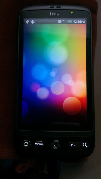

At the moment when I turn it on I get the pink swirling rings then I get the word android mirrored come up then I get the standard htc rainbow wallpaper and the notification bar but there is no ring or bar or whatever it was to slide and unlock. There is currently no SD card or sim card inside and I've tried doing the volume down / power button start up but it doesn't go to the white screen like I vaguely remember in the past but instead just boots up the same as I mentioned before.

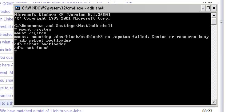

It says that debugging is on when I plug it in, I've tried following your guide but I don't think it worked for me.. first time I tried it said adb server was out of date then it said killing something..
second time trying had this outcome (see attachment)
when the phone is booted no buttons have any control except for the power button for turning the screen on and off, long hold doesn't bring up the shutdown message - the only way to reboot is ejecting the battery.

If you are in adb shell try exit. Then try adb reboot bootloader.
When you type "adb shell" then return you are in a linux shell on the phone. So whatever commands you then type go straight to that shell (login session). You need to exit it before you can use other adb commands - that's why you typed "mount" rather than "adb mount" then.

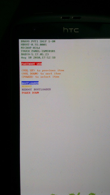

Ok, so you are S-On, so no need to worry about memory partitions. :)
Can you use the volume key to select "fastboot"? If you can then you can run an RUU when it's in fastboot mode, and it should be fully working. Unrooted, but you can root again if you want. If you do this the 2.3 update would be my RUU of choice.
Or if you select recovery you can do a factory reset, and install a rooted stock ROM if you prefer (which won't need a partitioned card to work). Can dig out links later (there is a section for rooted stock ROMs in the list of ROMs linked in the ATR sticky post).
I'm going to go for the unrooted option, does the RUU file need to be on the sd card? because I still don't have access to that on the computer
The RUU is a windows .exe. You run it on a PC while the phone is connected by usb and in fastboot mode (as shown in your picture).
Being in fastboot mode means whatever funny state the ROM is in won't matter, because the ROM isn't running.
